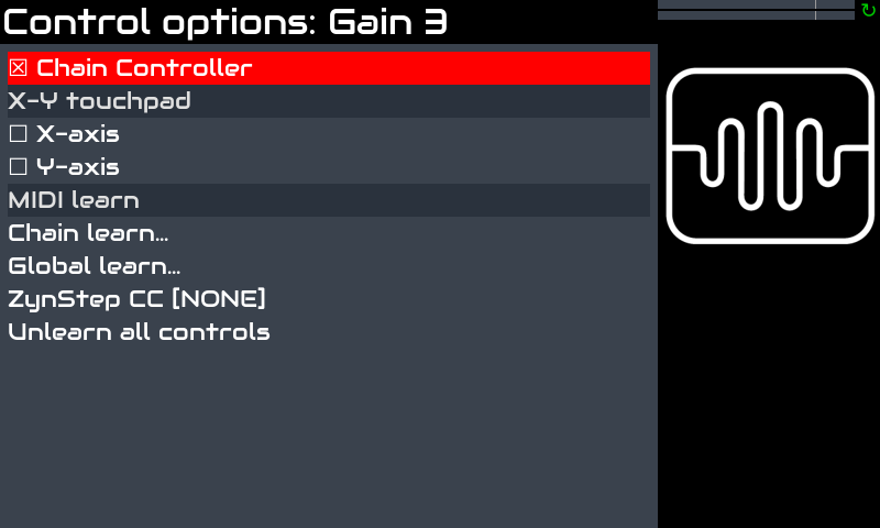

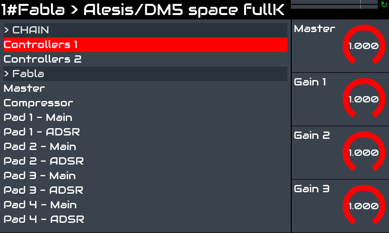

I just implemented the “controller favorites”. They are called “Chain Controllers” and displayed at top of the list:

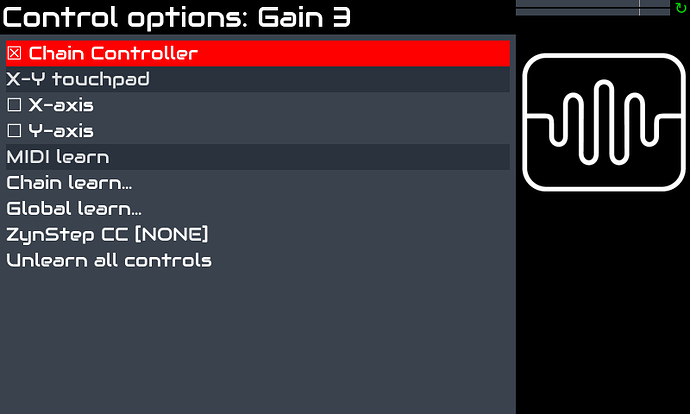

You can check/uncheck any controller in any processor in the chain. Simply access the “controller options” by bold clicking the controller:
And you can add as many “chain controller” as you want. No limits. They will be ordered as you add them.
Of course., they are saved/restored with snapshots, If you remove/replace a processor, the controllers are purged from the list, etc.
