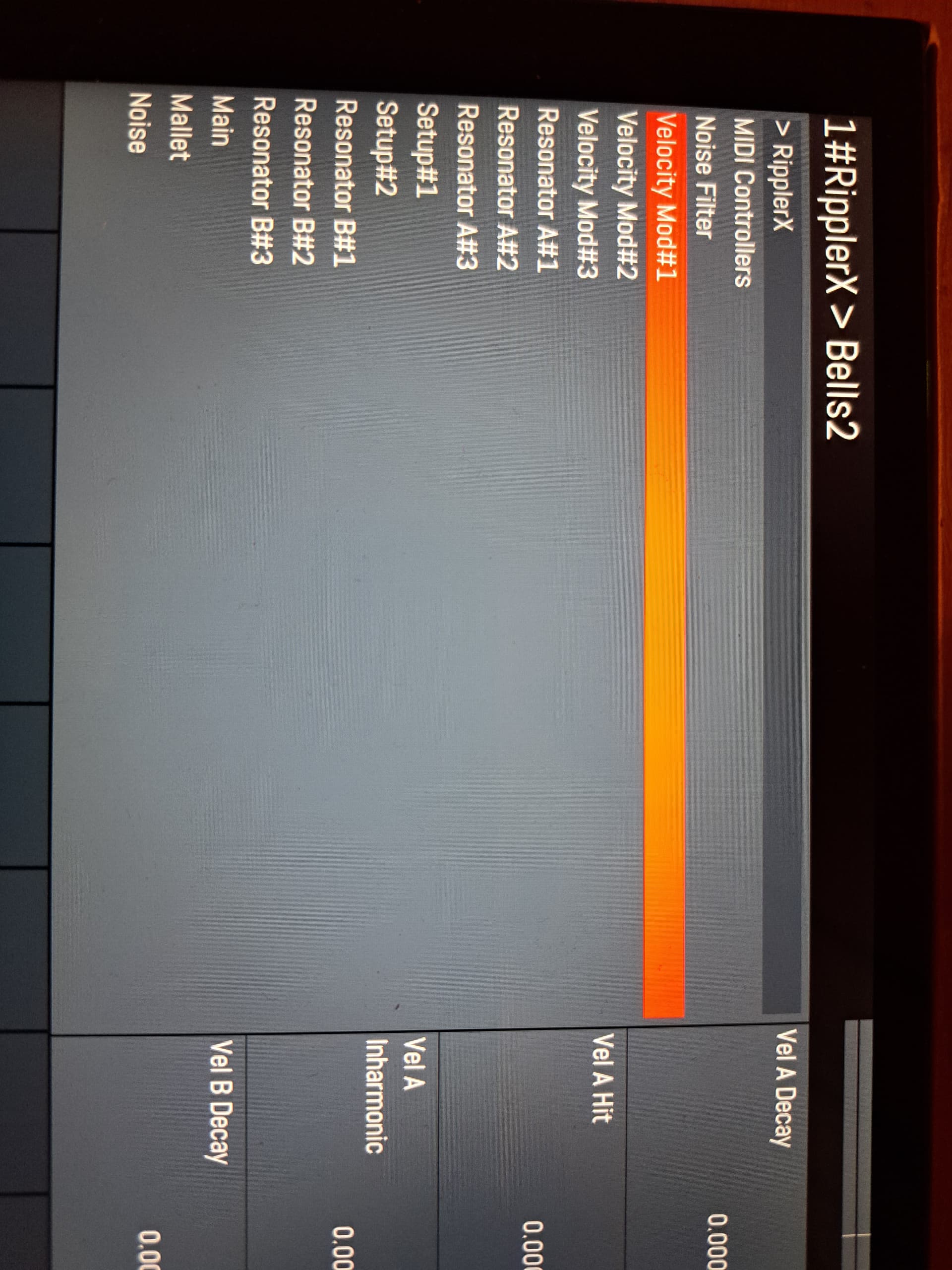

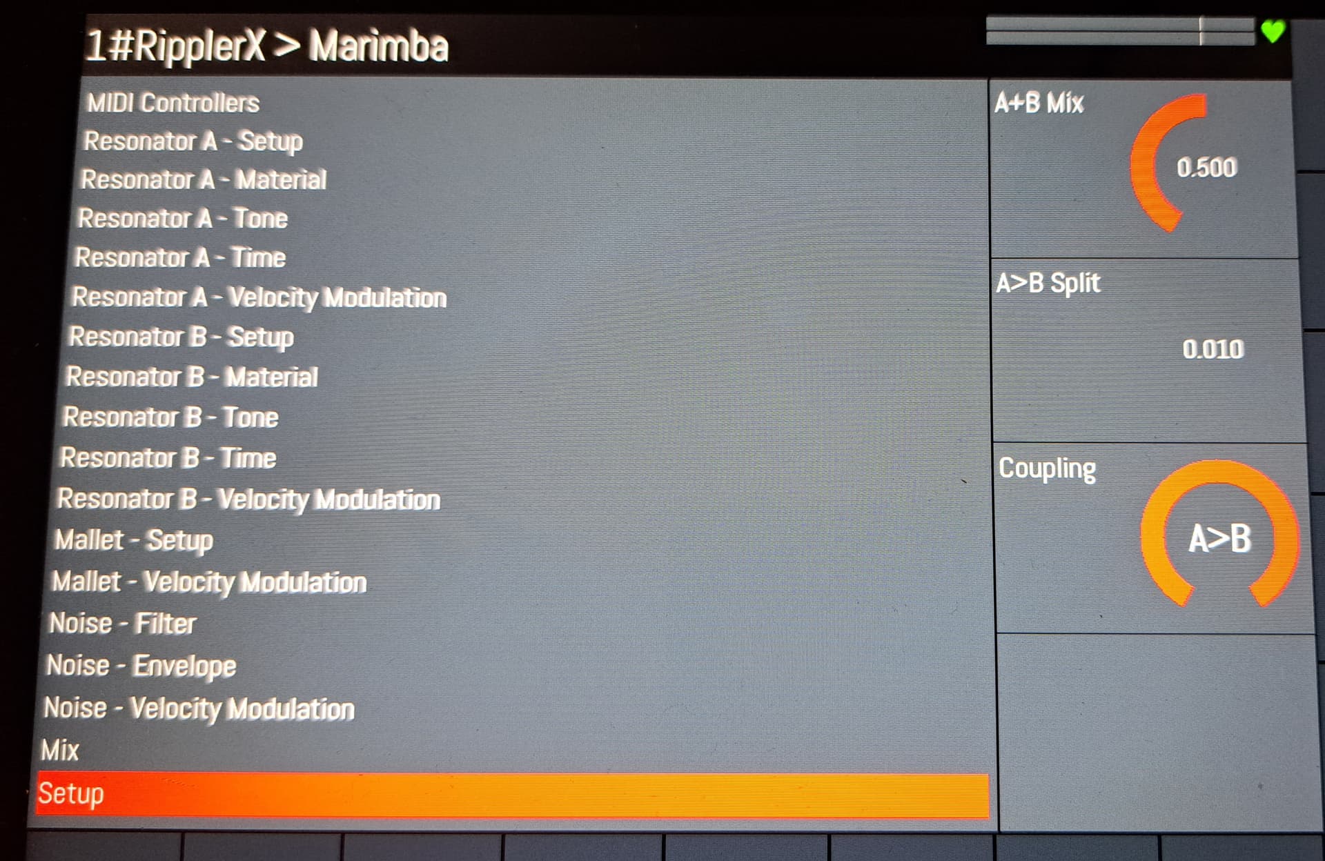

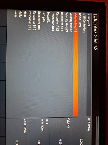

I do not speak this language, but from reading the examples it means to add groups to the bottom of the file
[filename]_lv2:[GROUP ID - arbitrary name but basis for ordering alphabetically]
	a pg:InputGroup, pg:ControlGroup; # Don't understand the difference
	lv2:name "[GROUP DISPLAY NAME]" ;
	lv2:symbol "[GROUP ID IN LOWER CASE]" .
Then adding each parameter to a group
pg:group [FILENAME]_lv2:[GROUP ID] ;
and add in case it is a adsr param:
lv2:designation param:[attack/decay/sustain/release];
Correct? But to be honest, I am a bit overwhelmed.

@jofemodo , I’m already doing something here. I have control groups now and the parameters assigned to it. Do I order the pages and params with
lv2:displayPriority *;
or
lv2:index *;
Do I have to keep the params in order then? Because there’s some ordered list
patch:writable
patch:readable
In vst I remember it was critical for patches to keep the param id order intact.
And if I’m already here: Is there a shorter way to updating the lv2-custom file to the plugin folder than updating the system?
You sort parameters with DisplayPriority. First parameter on each group determine group ordering. This can be a little be confusing.
Ok, so I keep the order in the file intact and use the priority. And it’s also usable for ordering params within the group as well as groups itself?
And what is lv2:index 1 ; good for then? It’s used in several ttl’s.

So here is my submission. That was tough.
dsp.ttl (20.3 KB)
Now that I got a bit into it, I had some questions in case I had a rush on editing other ttls:
  1. How will my future updates in vangelis work? Will there be a merge conflict since I just created a file in a git observed file system?
  2. is there a comprehensive tutorial here on how to edit custom-lv2 ttl? (ignore following questions, if so)
  3. Is there a guide about how a meaningful order of parameters should be implemented for different engines already?
  4. Like asked above: what is the purpose of lv2:index 1 ;
  5. Can I assign custom parameter display strings?
  6. Can I reorder parameters without breaking the functionality?
  7. Is there a guide about lv2 parameter editing in terms of param shape or any transfer functions, enum handling (int to string conversin), data type (double/float/int/bool) and so on regarding these kind of ttl editing already?
I’m asking all this because I could really imagine diving deepee into this system to finally contribute something to this great project, but I would definetly need a “bold push” to get there.
Hi @hannesmenzel!
These are all good questions. The LV2 documentation is painful. It is the kind of documentation that makes sense, only after you understand the concepts, i.e. you don’t learn from the docs but instead have to work out (e.g. from other examples) what is meant then you can understand what the docs mean… well that is my experience!
The update mechanism in zynthian tends to overwrite existing changes. If you manually git pull then you have to manage conflicts yourself. Basically, you should chose to use the normal user update method if you are a normal user of manual pull/merge if you are a developer. I seldom use the normal update methods - only if testing the update mechanism.
Probably not. Check the wiki. A search for “LV2” shows a few pages with varying relevance.
No! We tend to be sympathetic to the upstream design. It may seem logical to have some form of uniform approach, e.g. oscilattors then filters, then envelopes, etc. but this may mess with the workflow of a synth and is not necessarily good practice for all engines. We hope that upstream developers have already considered this (though in practice many don’t). Mimi-d is an example where the upstream developer is very concious of zynthian implementation and considers parameter order and grouping carefully. Others have different targets in mind so may have different criteria when planning this.
This is the unique id used by the source code to identify each parameter. These must not be changed. They do not signifiy order. They are simply uids.
Yes. The “lv2:name” parameter is for display purpose only. The “lv2:symbol” parameter is the UID used by clients / hosts to identify the parameter. (It is poor practice to have redundant data, with index and symbol both acting as a UID but they must both remain unchanged.)

What I applied yesterday in the ttl above is to use distinct display priorities. When using 1,2,3,4 in each respective group I don’t know how to fix the group order. So what I did is starting with 99 and go backwards to order both the controls within groups and between groups alike.
You mean I could apply display priority to both groups and controls? That would have been easier.
By the way, my questions towards “guides” and “tutorials” was maybe a bit misleading. I rather thought also about weather there was a discussion already which lead to agreements how to do that.
No, what you did is right. Zynthian uses the display priority parameter to order controls and the group parameter to group them so, if you want to order groups, you need to use display priorites across groups, e.g. to show the filter group before the oscillator group, assign higher display priorities in the filter group than in the oscillator group.
Be aware that these are not saved in the snapshot so, if you want to change the order, it can be done in the ttl and will be used next time the engine is loaded.

I meant if I can reorder the position of the respective parameter implementations in the file.
Hi @hannesmenzel and @riban!
We could implement displayPriority for groups, so ordering groups would be a lot easier. Of course, this doesn’t mean we have to modify current TTLs, but it would simplify further work.
@hannesmenzel, once your custom TTL is ready, you should do a PR to zynthian-data repository, so it’s managed in zynthian updates and available to all users.
It is ready. Sorry, but I don’t speak git fluently and don’t know how to do that.
EDIT: Well then, here is the PR.
This one I did not figure out though.
Merged! It’s already available in vangelis branch. Just update and enjoy!
