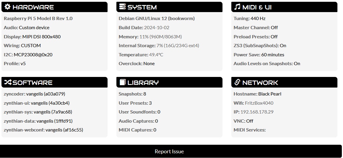

Hi @petr! There have been no reported issues with Pianoteq on a V5 with RPi5. Will you please post a screengrab of your webconf dashboard which will show us the versions of zynthian software modules in use? Have you done all required updates? (Update available is indicated by a broken circlular arrow in top right corner of the main UI.) Do you have the issue with other engines?

You should’t be using V5 kit config unless you have a kit V5. When using custom hardware you have to configure all your subsystems from scratch.
