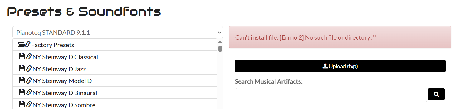

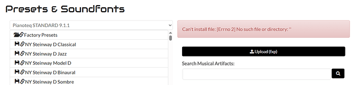

I had this issue with Vangelis today reflashed:
Is there another way to add fxb presets i.e. by Filezilla?
Definitely! (Using shh/winscp/internal file browser)
Or the filebrowser in webconf?
Exactly, I meant that by “internal file browser”. I didn’t try it though and use winscp, but it should work as well.
