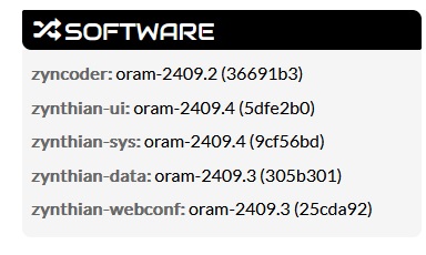

Sorry for the question… I have the latest version? If it’s not the latest, how do I update? I can’t do it in Zynthian… Thanks
Immagine
Yes, you have the latest stable version. ,
I upgraded a while ago and I have the same version:
zyncoder: oram-2409.2 (36691b3)
zynthian-ui: oram-2409.4 (5dfe2b0)
zynthian-sys: oram-2409.4 (9cf56bd)
zynthian-data: oram-2409.3 (305b301)
zynthian-webconf: oram-2409.3 (25cda92)
Many Thanks…

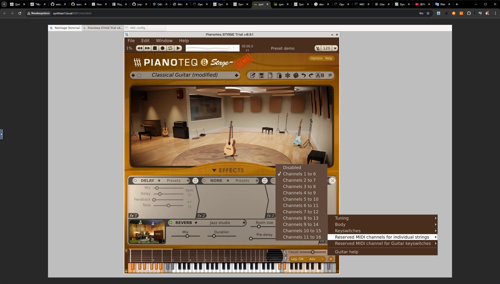

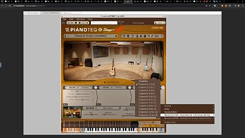

The Pianoteq Guitar module is interesting, but from my perspective, it lacks the ability to use multiple input MIDI channels in Zynthian.
I used a Fishman TriplePlay MIDI pickup on my guitar, configured with each string assigned to a separate MIDI channel via the FC-1 pedal. I set its input in Zynthian to multichannel mode. In Pianoteq, I tried enabling “Reserve MIDI channels for individual strings.”
As expected, it didn’t work because Zynthian only sends a single MIDI channel to Pianoteq. I tested the same setup on a Windows PC, where Pianoteq successfully handled input from the first six MIDI channels without any issues.
Is there a future possibility to modify the MIDI input signals to the chain engine to support multichannel?
