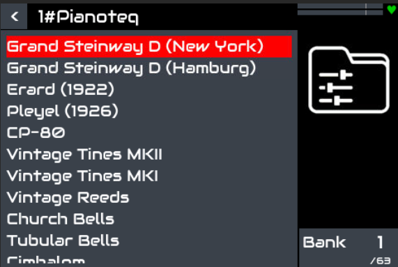

Presets will access all the instrument packs. I have Pianoteq Stage V8 with the Steinway and the Electric Piano instrument pack, plus the additional bundled historical packs and demos of the rest. All are accessible from the Preset menu. Each group within each instrument pack is presented in the “Bank” view:

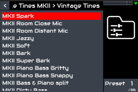

Then each individual patch/preset is shown below these in the preset view:
So you can select all the saved instruments, including customised, personal saved presets.
