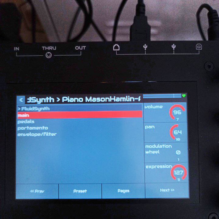

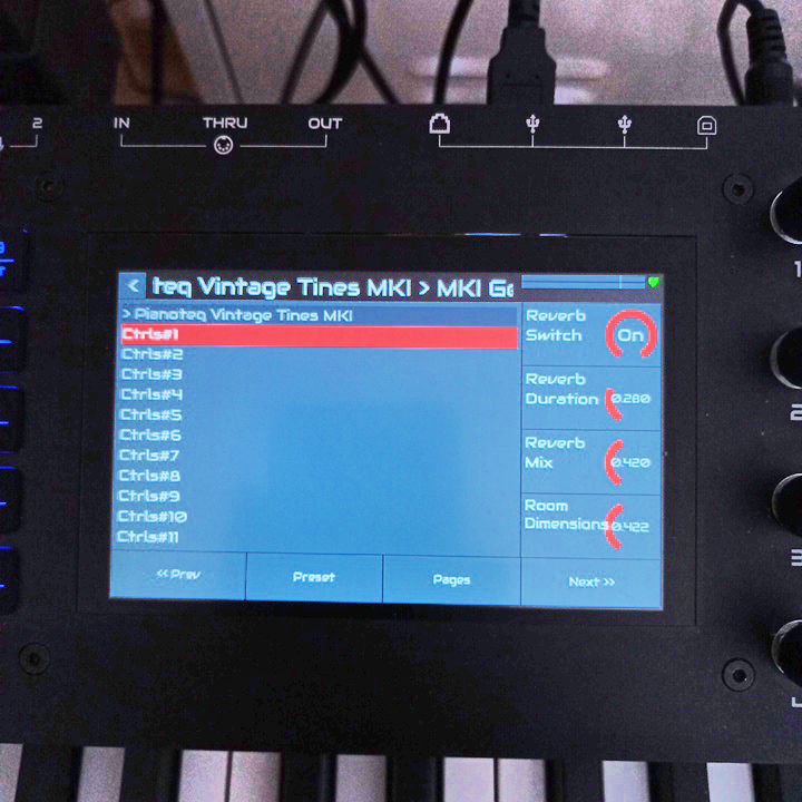

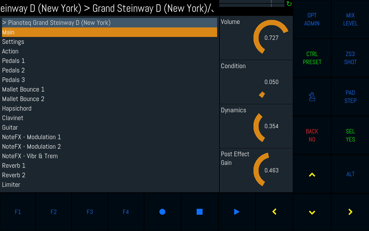

I don’t know why with v5 the first settings screen it lacks the VOLUME, PAN, MODULATION or CONDITION (really interesting), showing instead REVERB SWITCH, REVERB DURATION, REVERB MIX and ROOM DIMENSIONS.
Attached: first settings Pianoteq screen vs first settings Fluidsynth were are shown VOLUME, PAN, MODULATION WHEEL and EXPRESSION.
As long as I remember on V4 this settings were all accessible.

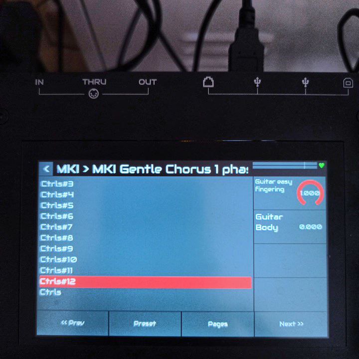

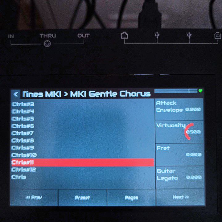

Referred to Pianoteq too, another question is related to UI and controls.
I suppose that given the lots of controls of Pianoteq; on Zynthian it has been made a rearrange to show the most relevant of them.
If so, why do I get adjustments of GUITAR LEGATO, FRET, VIRTUOSITY, GUITAR BODY or GUITAR EASY FINGERING when I am playing a PIANO? I should prefer a more comprehensive access to effects instead, if possible.
2 new screenshots attached showing this controls under Piano MKI Gentle Chorus.

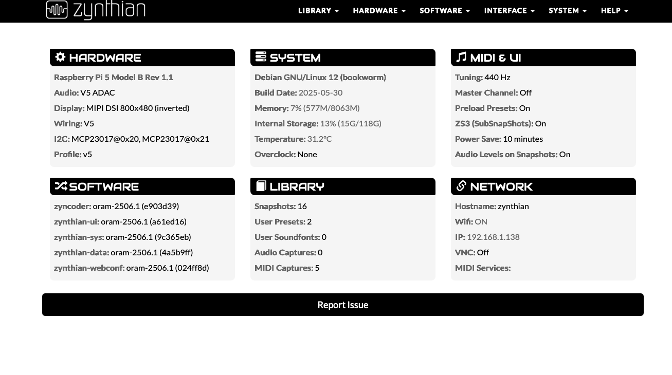

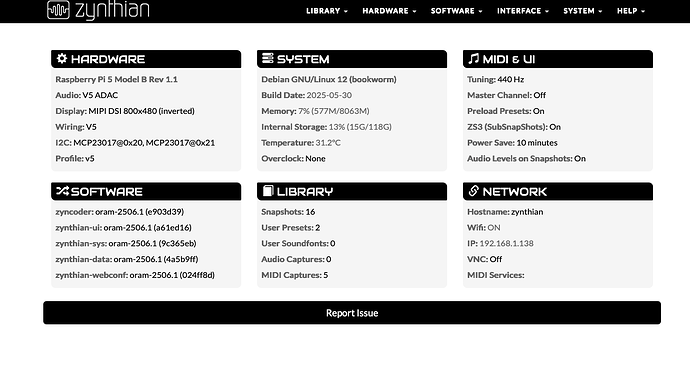

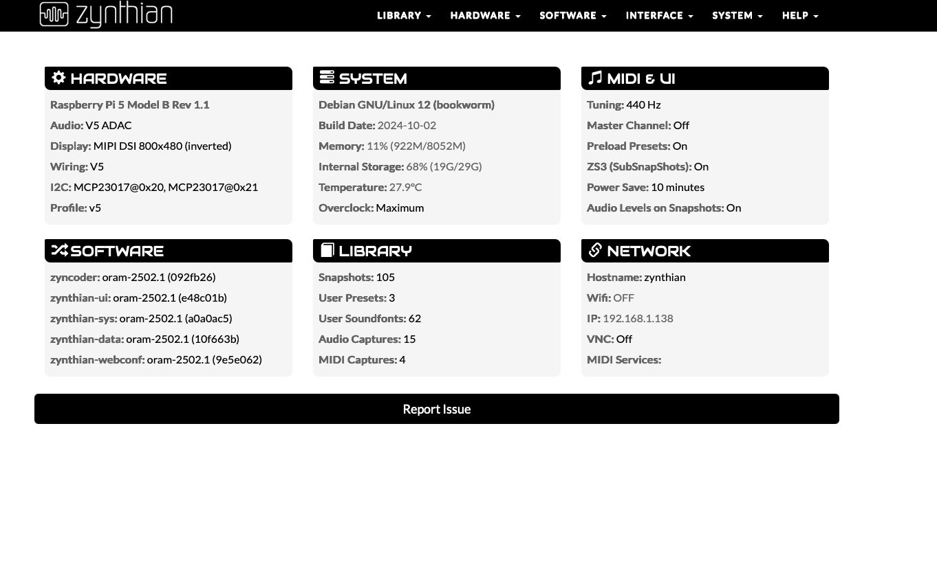

That doesn’t describe the version. Is it the “latest image”? The latest stable release? The latest update to testing? The latest update to any repository? Post a screengrab of your webconf dashboard so we can see what actual version you are running.
Of course. I submit a screenshot with the details
Looks like your hanging on the eighth-latest point release. Probably the way would be to really chose the latest stable on webconf Software->Versions and update afterwards. I don’t know if there were any reasons to burn a new image instead?

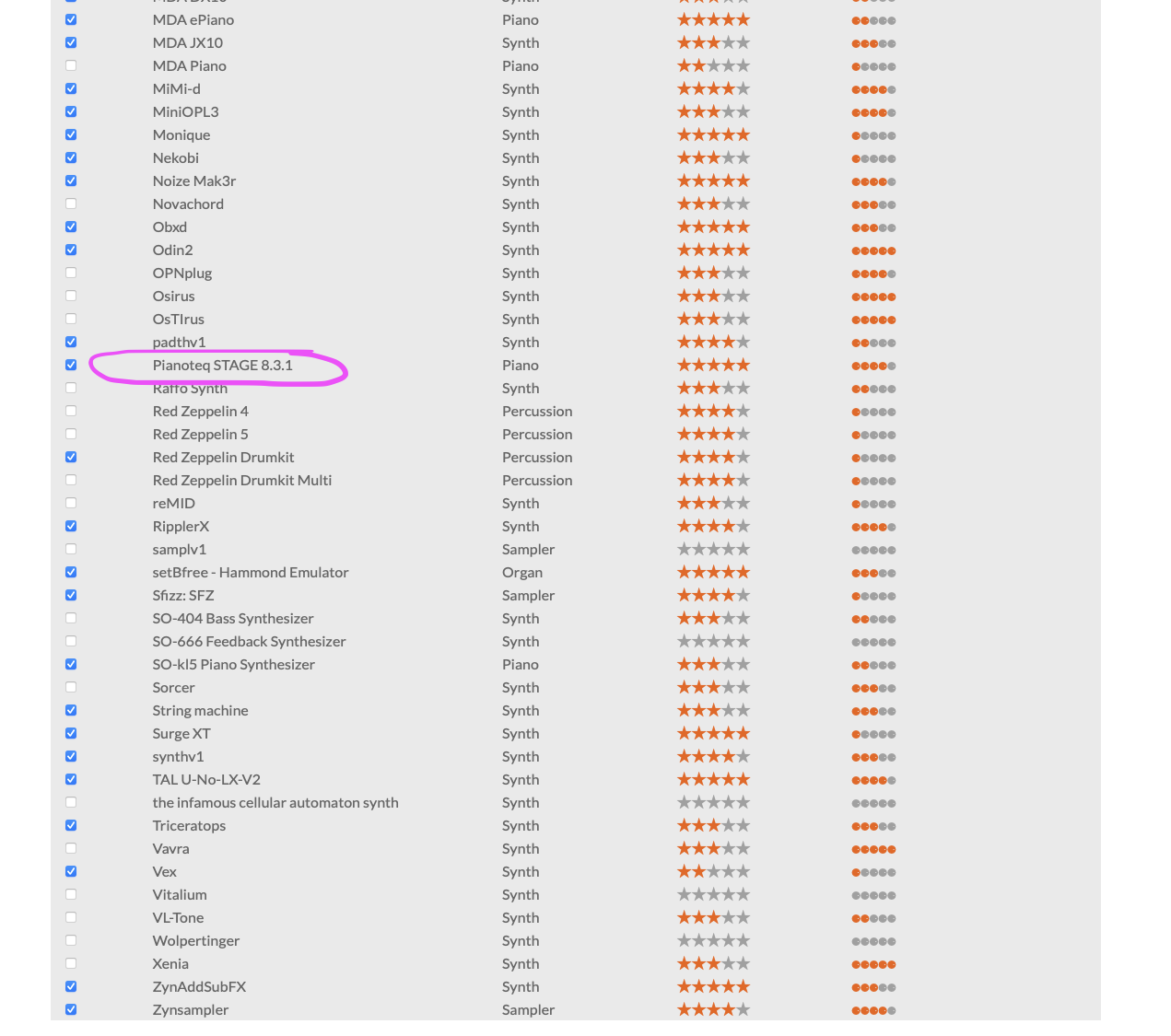

A new approach. In engines, the Pianoteq version provided is 8.3.1. However I installed 8.4.1. May this be a reason?

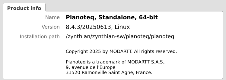

If I were you, I’d go to my engines VNC, go to Preferences → About in the Pianoteq UI and post what’s under your Product info:
My guess is you’re using a binary not supported/expected by the zynthian UI recipes. So it would be interesting how you installed yours.

Looking at the engines the default Pianoteq is 8.3.1 as you can see…
Now I will install my Pianoteq license and will give a try to see if all performs as expected and Pianoteq engines goes to 8.4.3 as well
Hi @hannesmenzel ,
Thanks a lot! I am seeing now the missing control VOLUME, CONDITION, DYNAMICS and POST EFFECT GAIN.
Issue resolved at the moment. Now I must to upload all my presets and test it again.
By the way the Pianoteq engine is still 8.3.1 after licensing my Pianoteq 8.4.1
