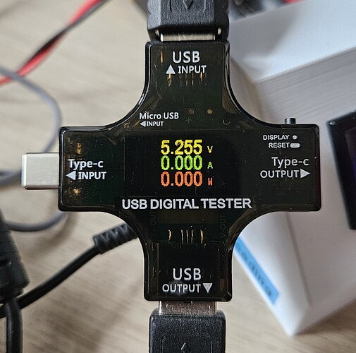

get yourself one of these
They cost about 10 euro and are always handy to keep in your drawer!
This is mine
Yes I’ll do that, and buy a midi tester :slight_smile:
