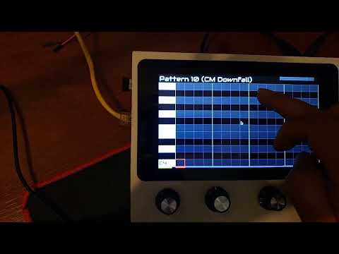

Short video in the

The video is good. It looks like the problem occurred during a bold press. That may give a clue to there issue.
That older version predates the multitouch driver but when you update you will move to a version with the driver so may encounter the same issue.

I tested with Raspberry Pi imager and Balena Etcher… Three diferents micro SD cards, only Dexed fail…
Thanks.
This fix has been applied to the stable build so you can return to stable branch and enjoy.
