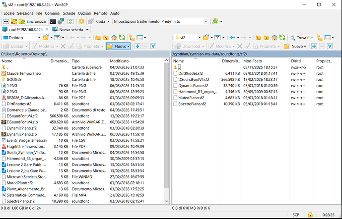

Many thanks Johannes and Jofemodo for your prompt reply! It’s a real pleasure!
I attached my Zynthian Soundfonts organization screenshot. If you need more deep info don’t exitate to ask for me.
Many thanks again and regards
Roberto
Hi @RobDal01 :slight_smile:
Did you make sure to peruse them from a Zynthian chain (in this specific case, a synth plugin on a Midi channel) loaded with the FluidSynth SoundFont rompler? (Instrument Category: Sampler).
