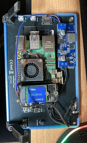

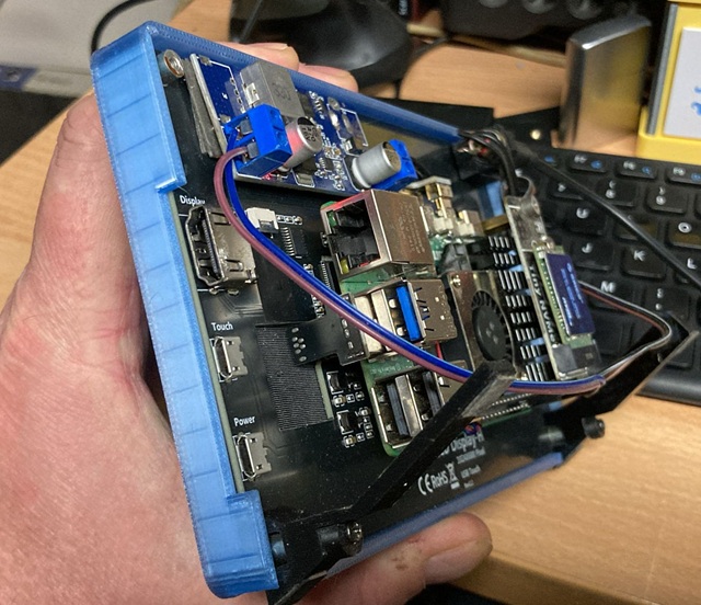

Hi, there are tons of ideas here on the forum, including many setup examples with displays of various sizes. Below are three pictures of my second Zynthian with a Waveshare HDMI '7 display. Good luck!

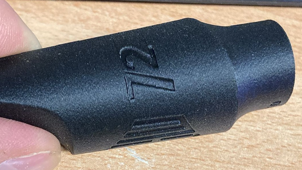

There are also excellent materials aesthetically. Below, for example, is a tenor saxophone mouthpiece I printed in PLA Carbon Fiber for a friend who plays the saxophone.
Since this is a test, I made this print with a 0.2 layer and a 0.4 nozzle… If it works well, I’ll make it with a 0.1 layer (unfortunately, I can’t use a 0.2 nozzle with Carbon Fiber).

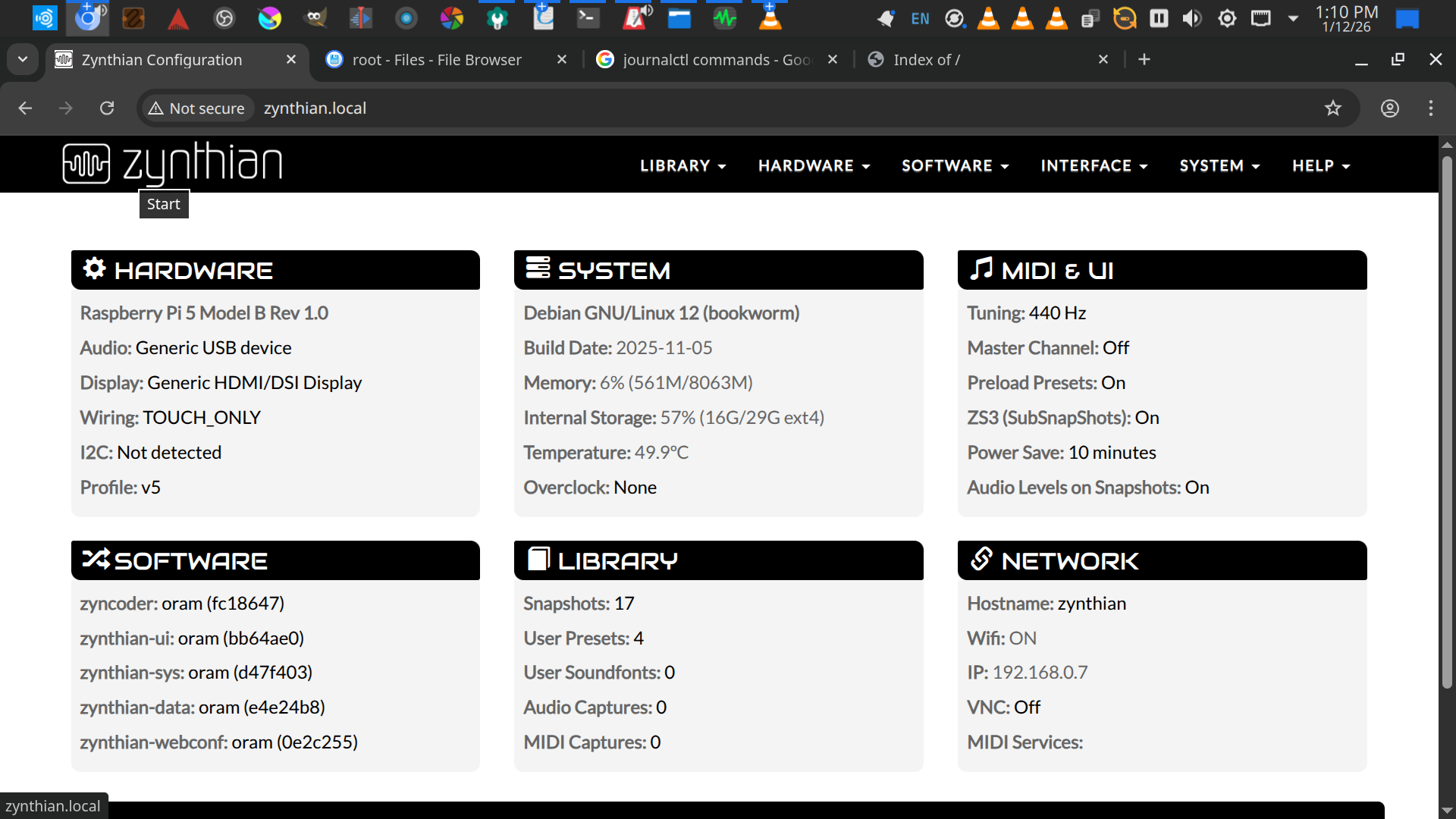

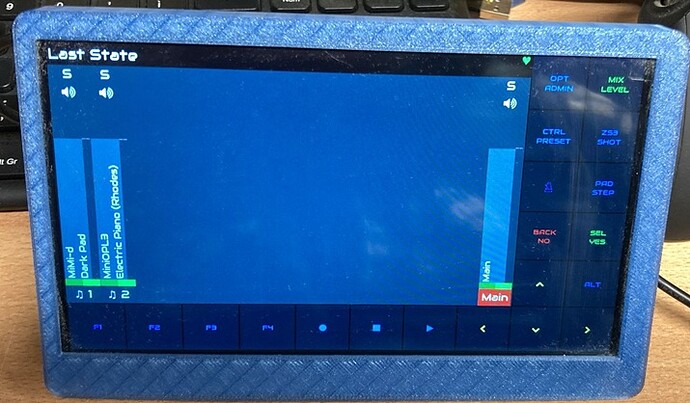

In the first photo above:
I do not see on my Oram Staging Zynthian the buttons along the bottom or on the right of the mixer.
How can I turn those on? I’ve looked around in webconf and the wiki. Here is my dashboard:
Thanks in advance…
Here. In my case: “Touch navigation = V5 keypad at right”. Ciao
Much Thanks, @Lanfranco that worked. Now all I have to do is get my Rasberry Pi Touch Display 2 7 inch screen switched from portrait to landscape and I’ll have usable Vangelis! I’m mentioning that in case anybody knows if it’s now supported or exactly what I have to do. I’m pretty sure others on this forum have done it, but there always seems to be a trial and error phase and then it works, I shall see…
