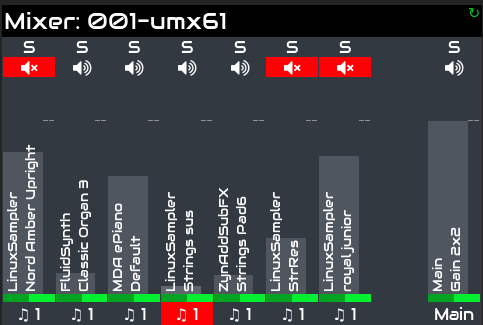

I would like to know if, when the channel is muted (as shown in the image below), there is still any processing happening in the instrument on that channel. Does it still use the processor and produce sound that is just muted, or is it not processed at all?
It is only the audio mixer that muted so it’s processing is slightly reduced but the processing of the chain continues.
Thank you for your attention. I’ll use a MIDI signal blocking plugin to make sure there won’t be any processing then. Thank you very much.
