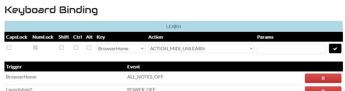

@HansR we use tkinter’s keycodes. The configuration in webconf does have learn so you could try plugging the keypad into the PC running webconf and try capturing the keys.
@riban I see learn on top of the Keyboard Binding screen but it is greyed out (not clickable).
Is that the right place?
The web interface is suboptimal. If the box is blue (as shown in your capture) then it is learning. YOu should see the key and modifiers update as you press keys.
[Edit] You may find that the OS hosting the web browser captures and reacts to the keys before passing on to the web browser.
I think I understand why it doesn’t work. The keys I mentioned are not known by the webconf.
I can’t find a list of tkinter’s keycodes, so I’ll leave it for now. It’s not important.

The python code for keymapping is in zynthian_ui/zyngui/zynthian_gui_keybinding.py. It contains lists of known keycode / key name mapping. I don’t have a keyboard with the keys described above so can’t easily detect their codes. They are likely to fail via VNC because the hosting OS will intercept and react to them. The binding is held in a file /zynthian/config/keybinding.json that relies on the names of the keys, not their scan codes or key codes. (That may seem odd but there was a reason that made sense at the time.) So, the current codebase does not support non-standard or esoteric keys. (Yeah - I know these are probably standard and widely available!) I think the issue I had with using scan codes is that they only represent the position of physical keys, not what the keytop shows, making them difficult to represent to multiple users with different keyboard layouts in different languages. Similarly with keycodes, they can be inconsistent. So I used the tkinter key names. Maybe there is room for improvement but this is a small usecase so quite low in the priorities. If someone wants to put in the effort to refactor this, ensuring it works for everyone in the world then great!!! :smile:
There is a comment in the code specifically stating that the required keybindings are unsupported. I think this is because the layer at which we access the keybinding within tkinter does not support these keys. It is possible to access the keyboard at a lower level but you must then do all the mapping of scan codes based on user configuration and physical keyboard which we seek to avoid. ChatGPT says:
The BrowserHome key is part of a group of special media or browser keys found on some extended keyboards (e.g. with buttons like Home, Search, Refresh, Favorites, etc.). Unfortunately, Tkinter does not natively support all of these special keys, because it is built on top of Tcl/Tk, which relies on the underlying OS and windowing system for key event recognition.
