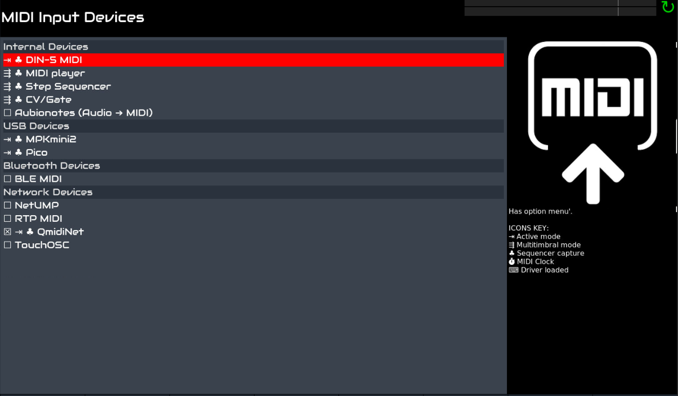

The most mature interface from a IP point of view is probably OSC.
Then there are the various IP based Ethernet MIDI gang.
And MIDI 2.0 is also discussed.
There is a certainly carefully considered design choices to be made if it isn’t to become messy.
We would probably benefit from having some priority of CUIA ordering established by the local gods to allow the considerable conflicts our flexibility can produce resolved without routing hell whilst one is just preparing to give the audience your current rendition of Jump!
@Wyleu, yes, Open Sound Control is great as a messaging protocol for networking computers, synthesizers and alike. And it does not depend on a specific transport layer/medium. It sends data over standard Ethernet or Wi-Fi using UDP or TCP protocols. SO, we need to have a working network underneath it, and that’s the part I have been talking about.
