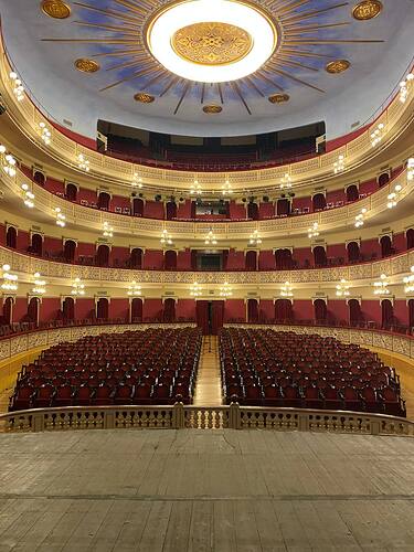

First, I would like to introduce the theater:
As you can see, a nice piece from end of XIX century.

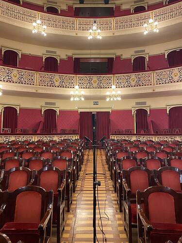

  • 3 points at different distances in the center corridor.
  • For each point, we would do 4 recordings:
    • sine sweep, stereo recording with a pair of little capacitor mics
    • sine sweep, mono recording with an omni-directional microphone (AKG)
    • clap, stereo recording with a pair of little capacitor mics
    • clap, mono recording with an omni-directional microphone (AKG)

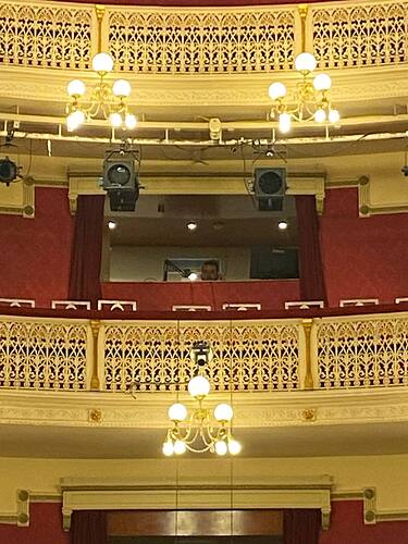

I was all the time in the control room, near the roof:
Silvio was in the pit, placing the mics and clapping hands :wink:
