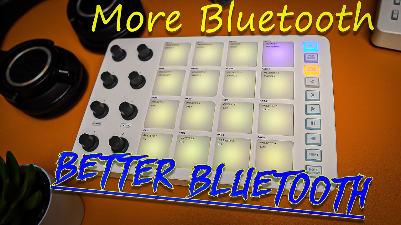

This one is in their catalog and has more feature for the same price:
with 8 encoders, midi over BT, USB, and serial midi through 3.5mm jack, it can run on batteries.
[edit] it looks like there’s a built in arpeggiator, and device configuration is done from an external computer via a softare downloadable on their website. Win and MacOs version are available.
Review here:
[/edit]
All these control surface do not have rotary encoders with the switch function (at least, the ones I know), so there will be always a workaround to find for short/bold/long push.
