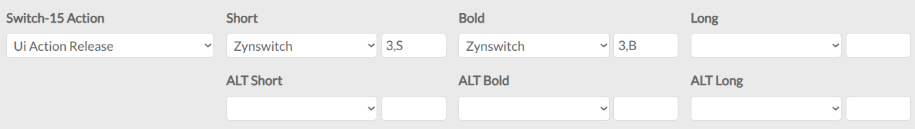

Am I correct that I should start looking in the “Wiring” settings in the web interface? I failed to document what it was looking like when I started, but this is what I believe is the relevant entry. Can someone tell me what, if anything, is wrong here…and if it is correct, where else I should look regarding this?
I have tried changing the configuration to custom and then reloading the v5 settings. I couldn’t tell that that did anything either. So, if there is a best way to reset the button assignments to their default settings (correct for v5.1), please lmk. I have been getting by using Enter on my MPK249 or the knob 4 press.

You can save your profile then recal the default but for your benefit, here is the V5 config of that button:
Thank you so much. That, of course, fixed it. That makes life so much easier. :laughing:
