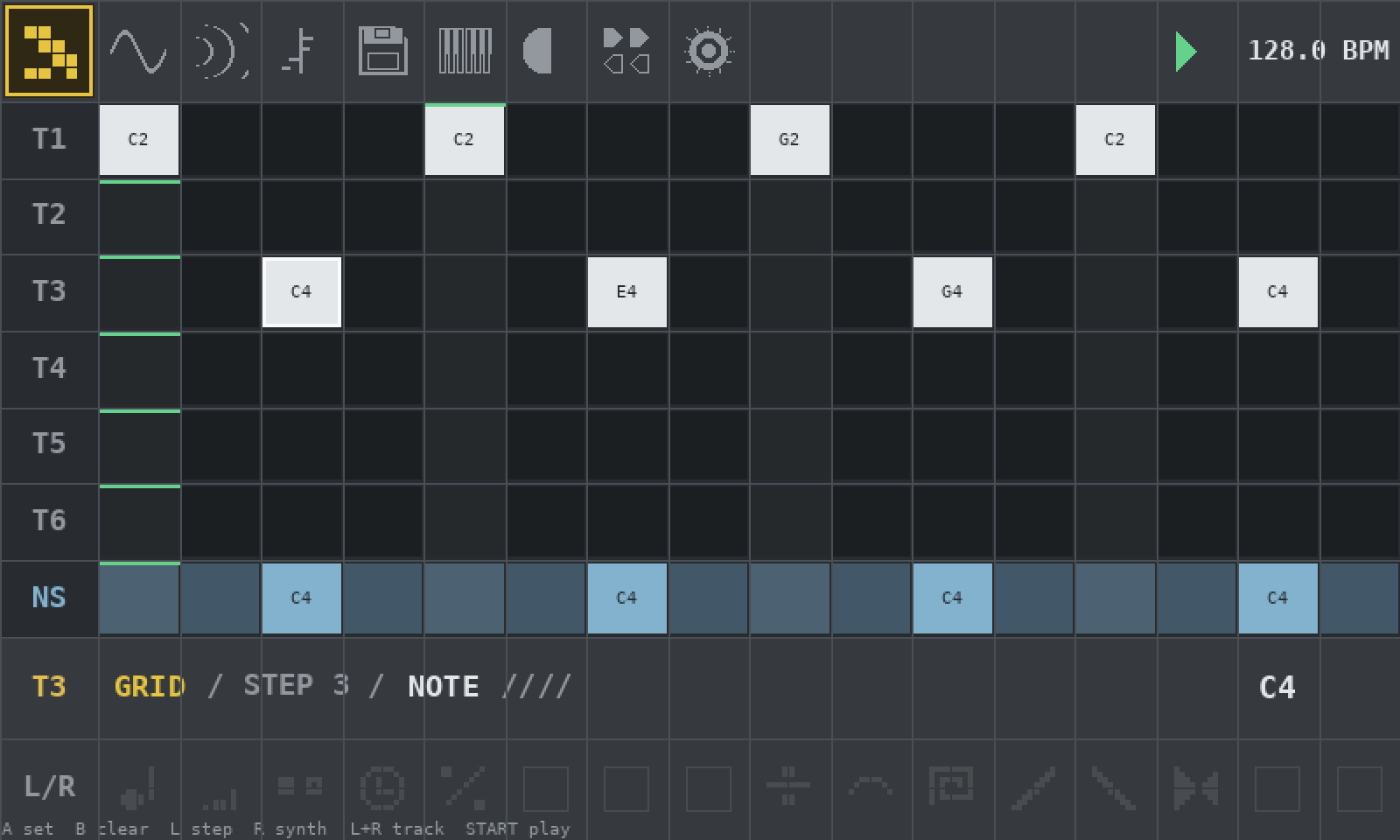

So i fell in love with fsm by fors.
it is a sequencer you navigate with a gamepad. its sends to several different midi channels and sends cc messages for lpf changes etc per step.
