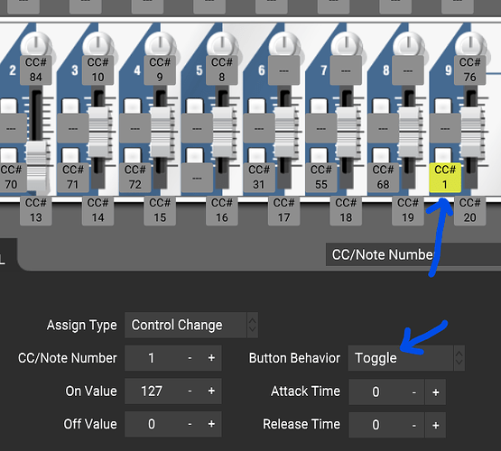

I ask your help to control setBfree Rotary speed toggle with Korg NanoKontrol.
Nanokontrol Settings are:
When I set CC#1 for rotary speed parameter of setBfree and I press the button nothing happens,
but Webconf MIDI Log shows the CC value change at each button pression :
CH#01 CONTROL_CHANGE 1 => 127
CH#01 CONTROL_CHANGE 1 => 0
etc…
what is wrong?
(Workaround found: set button as CC#64 momentary)
