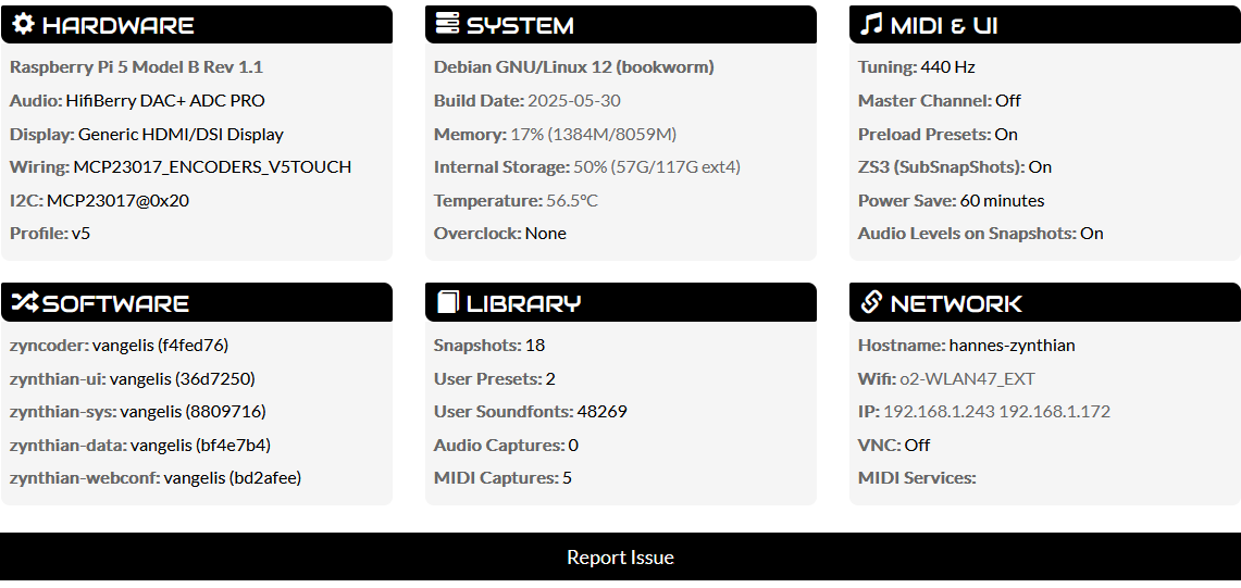

Hi @hannesmenzel !
What version are you using? “Oram Stable”, “Oram Staging” or Vangelis?
A screenshot from the webconf dashboard would help.
Also, could you send your yaml files and the SFZs if they are not included in ZynthianOS? If the SFZs are not “free”, send by PM.
Certainly, I’m on the latest vangelis from like some minutes ago.
I can tell that every soundfont having yml shows this behavior, and that all of them worked before in that exact state. I thought I missed some yml syntax revision. Here’s one example:
Tubular Bells.sfz (4.6 KB)
common.yml (362 Bytes)
