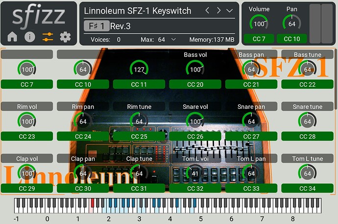

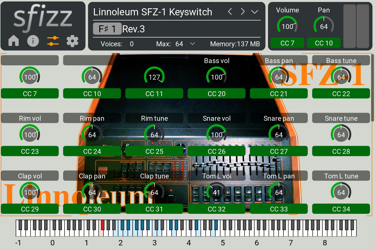

(Would love a screenshot :slight_smile: )
Updated Linnoleum SFZ-1 so that the midi-controls are sorted per sound instead of columns.

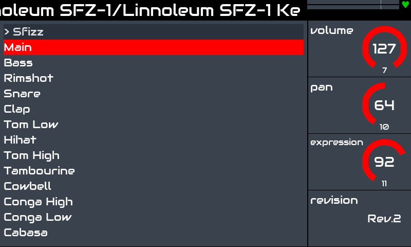

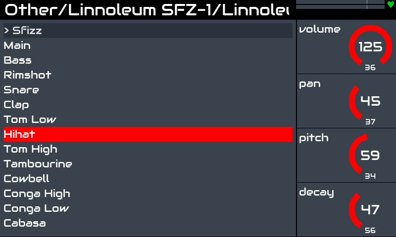

and fixed the YML files so now it works like a charm in zynthian. Congrats for your excellent work!!
These are the fixed YML files for the zynthian UI so you can include it with the SFZ bundle:

Today I got busy and studied Linoleum’s sfz and yml files. Good work and credits to @jofemodo and @NathanI .

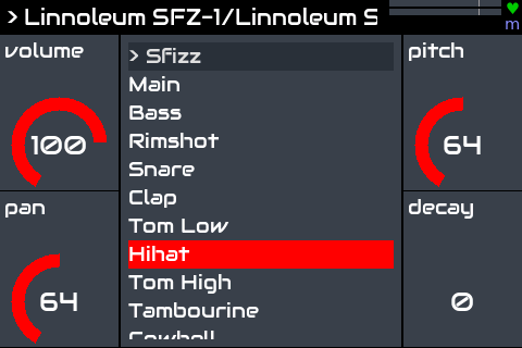

Hi, please what has changed in sfizz? I’m playing with yml files now and I found out that Zynthian UI doesn’t show me the assignment to the CC channel. And of course it doesn’t work either. I tried Oram 2025.6 and Oram staging, it’s the same in both.
For a better explanation I’m attaching a picture.

Please try on your Zynthians engine sfizz withLinnoleum SFZ-1 fonts and common.yml and Linnoleum SFZ-1 Keyswitch.yml files. Does displaying the CC number work with these files in controller widgets? If so, I’ll look for a bug somewhere on my end.
Hi @ToFF !
Yes, it display CC numbers, but assignation is wrong. Parameter names doesn’t fit the effect on sound. Strange because i tested in May and it worked OK.
I will keep with my tests …
OK! I managed to reproduce this issue (the cc numbers gone!). To reproduce:
  1. Create a chain with sfizz and load Linnoleum SFZ-1 Keyswitch. CC number are shown
  2. Save and reload snapshot.
  3. Load a different preset. The CC numbers has gone.
I will fix ASAP.

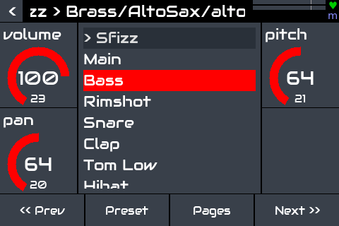

I can see CC now and it works.
But another problem has appeared. When I change the preset, the UI still shows the previous options, i.e. it doesn’t overwrite it according to the current yml, or if the yml file is not there, it doesn’t return to the default state, this applies to the standard sfz files distributed with Zynthian.
The way around this is to replace it with a new instance of sfizz.
So I have Alt Sax with rimshot :slight_smile:
