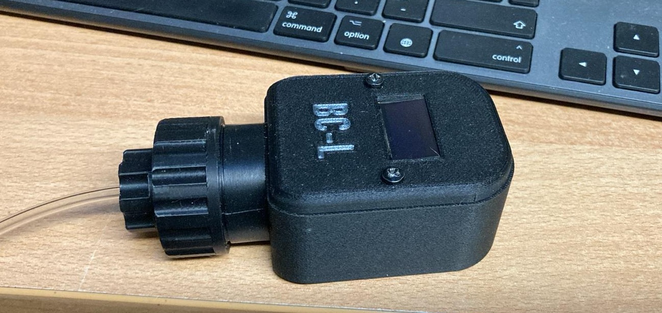

Raspberry Pi PICO version completed.
Excellent! No soup for you tonight!
Looks great, I like the engraving of BC-1. What happened between 2/25 and 3/1 - did you find and fix the firmware or accept the ‘poor sensitivity and nasty “tongue” effect’ or ?

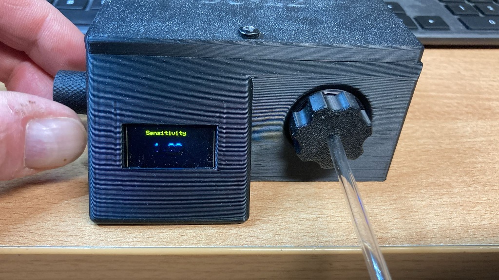

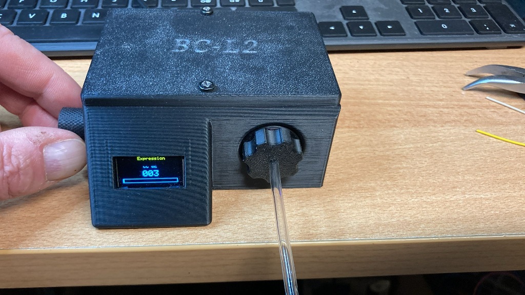

I’ve improved the sketch using AI, but it still doesn’t work as well as the Teensy. Since I hate having boards with soldered wires on my desk, I’ve finished printing the case, but I’m not at all happy with the result so far.
I’m testing different pullup resistors (which made a difference in the Teensy), but I eliminated the trimmer, which would have been more convenient, but 2 cm of wire was enough to make it uncontrollable.
If anyone wants to take a look…
I used the “reverse printing” technique with my 3D printer. But it’s not a BC-1, but a BC-L (Breath Controller - Lanfranco). :smiley:
Breath_controller_PICO_NUOVO.ino (5.9 KB) I used Arduino IDE 1.8.13 which for me remains the best.
I wanted to build a breath controller that would sit on my desk and add an encoder to adjust the “hardness” of the controller. BC-L2
