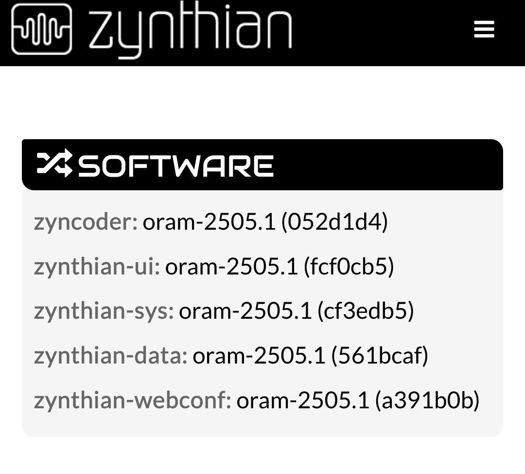

Wow, that was quick! And thank you for the detailed information, it was really helpful. :grinning: I updated Oram to this:
And under Audio out on the drum track (Instrument chain) I still cannot see the sidechain input on the synth track. Have I updated to the right version(s)?

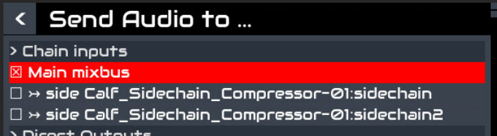

This screen grab shows what the audio output routing page looks like. Note the funny arrows that prefix sidechain destinations.
