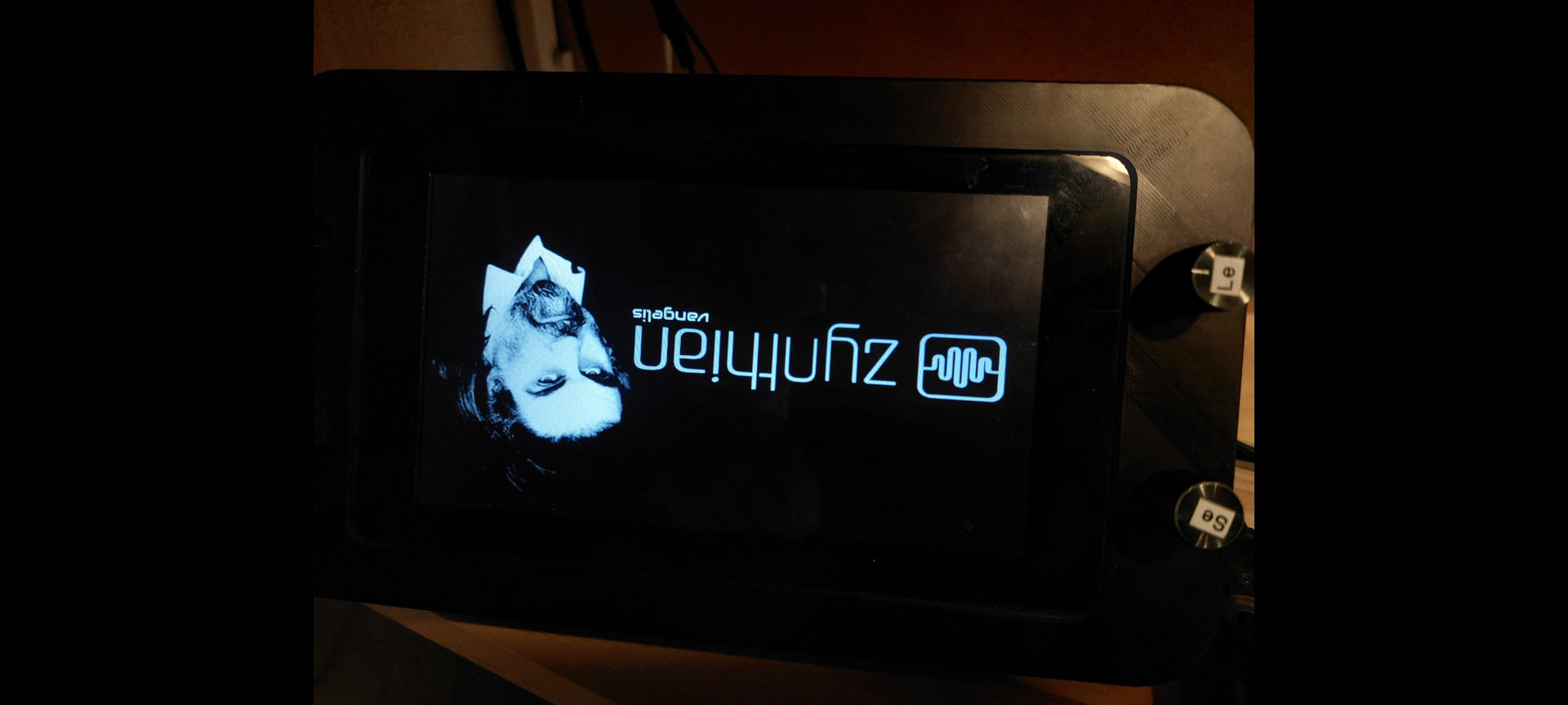

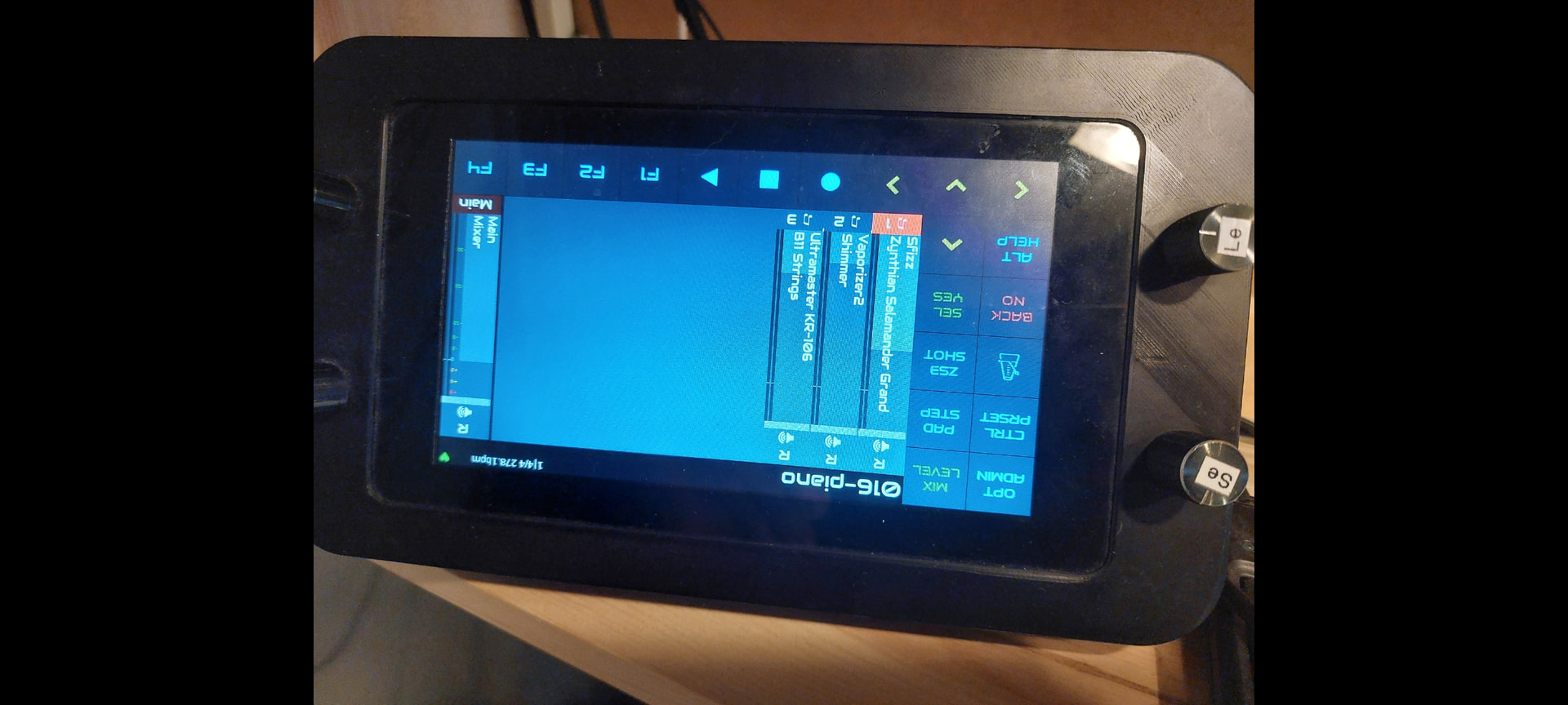

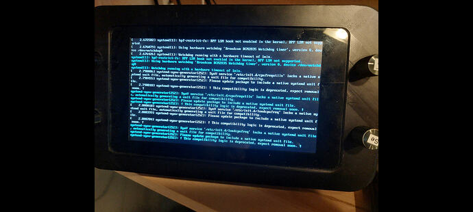

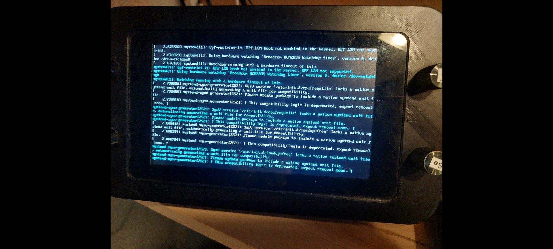

The commands work perfectly and rotate the screen. However after every (re)boot I have to repeat them. The settings with both Pi 7 Touchscreen Display 800X480 and MIPI DSI 800x480 make the screen start upright, but as soon as the Vangelis image shows up, everything turns upside down.
If I change the display settings to rotate, everything on the screen is inverted, the boot messages included. If I change the settings to normal, only the boot messages are upright.

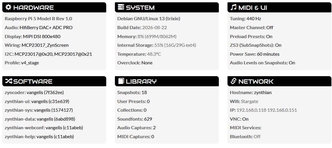

I have loaded 2026-08-22-zynthianos-vangelis-2608-beta.img on the SD card and updated ever since. These are my current settings.
I made a video of the start-up process, but it may be to large a file, so here some images:

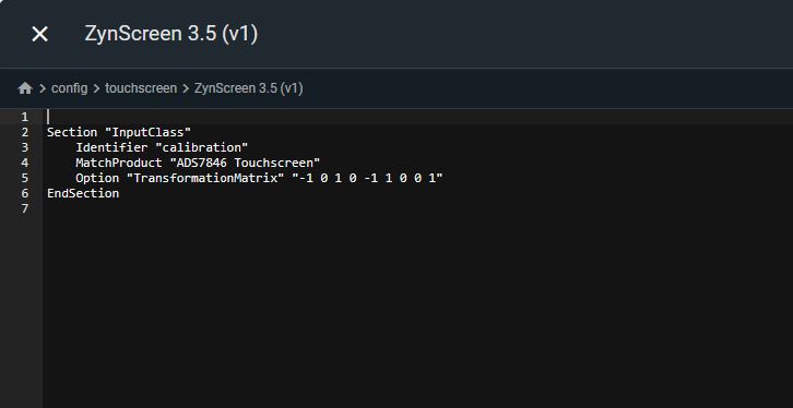

@ jofemodo
Maybe not relevant, but in the filebrowser section of webconf, I found this
Not relevant. This would only rotate the “touch” and it’s not for your display, anyway.
