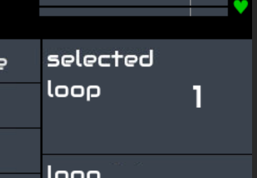

These are available on a control called, “selected loop”.
It may be possible to bind a physical MIDI controller to this control to allow selection of the loop. I think zynthian supports parameter feedback but am not sure how. If so, it may be possible to give a tally back to that hardware controller. Of course, we are getting into the realms of bespoke configuration - but that is what the MIDI learn feature is for.
There is also a control called “prev/next” that can be used to step through, selecting each track. And we have the (fairly new) “single pedal” parameter that allows driving SL with just one pedal.
