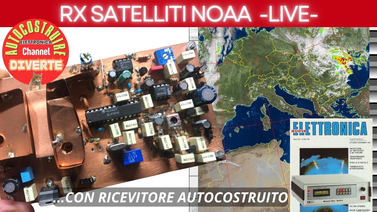

I am curious @Lanfranco , can you use the weather signals and turn it into sounds? Weather mod Matrix
Hi, the “sound” of digital (Meteosat) is practically unheard… it’s a very low-volume white noise-like hiss. The old APT weather satellites, on the other hand, used a signal similar to old fax machines, a whistling sound that repeats at the same pitch… Nothing as fascinating as Matrix. Below is a video of reception from a NOAA weather satellite.
You have to skip ahead a bit in the video until NOAA comes into hearing range.
Fascinating, thanks for sharing.
