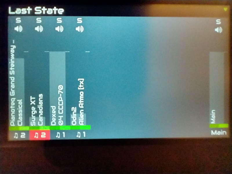

But there is something still not working as expected, when using the “active midi channel” feature. Here my setup:
  • chain 1: Pianoteq => midi channel 1, midi CC64 selected
  • chain 2: Surge XT => midi channel 1, midi CC64 selected
  • “active midi channel” activated in admin menu
When chain 1 is the active chain, then you can play with sustain pedal as expected. Sustain pedal is also working with Surge XT, chain 2.
But when you move to chain 2 (chain 2 selected), then chain 1 (Pianoteq) does not receive the sustain pedal message.
I think this behaviour is the same in Oram October release 2024.

May I asked this: After recent fixes (not sure if this is related) the pedals were taken from the default sfz engine controller screen. Were I did add them in custom controller yml scripts, the onscreen pedal controls do not react to cc64 changes.
The pedal function itself works. Is this behavior intended?
The pedal handling has been refactored in testing (vangelis). Controllers for pedals have been removed and you don’t need to bind MIDI CC manually. CC 64 (sustain), 66 (sostenuto), 67 (soft) and 69 (hold 2) are configured as pass-through by default so will act natively on synth engines. This can be changed in CC menu. In active mode, pedal press is remembered so that the release works even if is the active chain has changed. There is an indication of each pedal state for each chain in the mixer view.

I’ve just updated to the latest version and tried it out a bit with this setup:
Just a short snippet to demonstrate flawless switching with sustain pedal and “Active Midi Channel” turned on.
