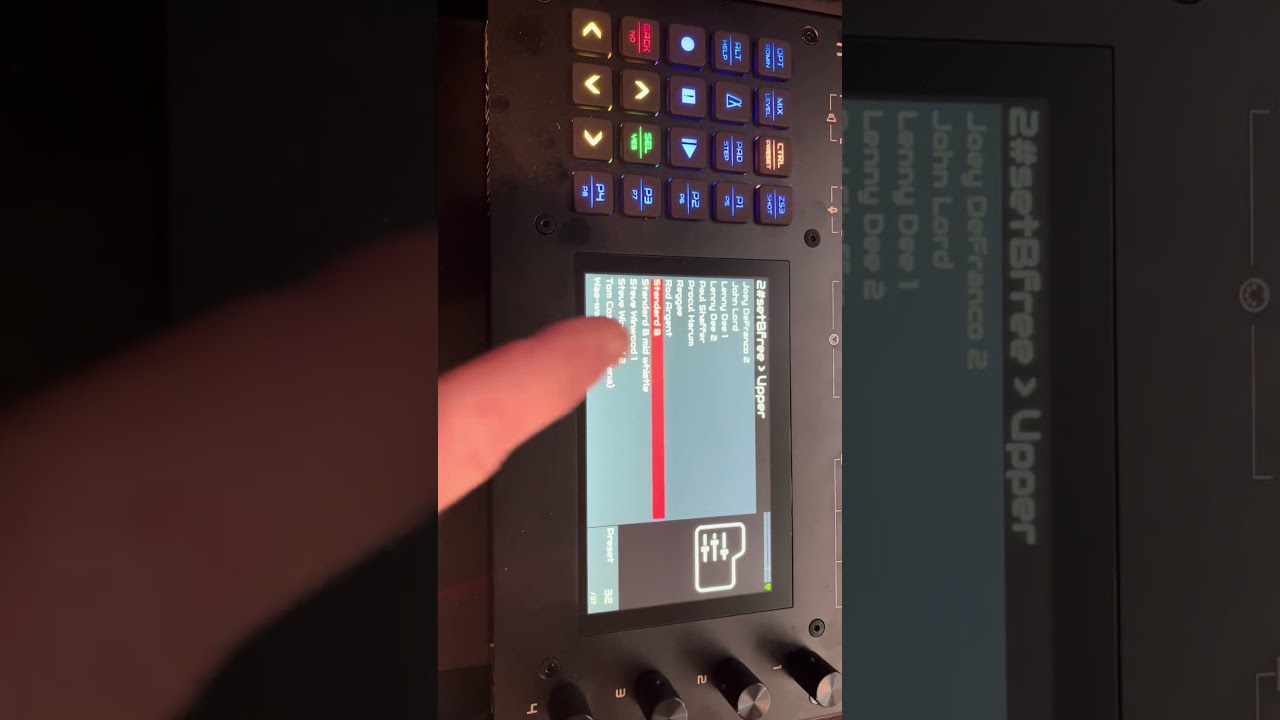

I recorded a video that shows the issue I am currently having with ZS3s and the setBFree presets:
I have attached my snapshot file here:
001-scs experimental.zss (642.4 KB)
Steps to Reproduce:
  1. Select ZS3 “0/11”. The Zynthian will load the correct preset for the setBFree engine, “Fredriks tfn 1”.
  2. Select ZS3 “0/10”. The Zynthian will load “Standard B” as the preset for the setBFree engine, but it is not the right sound for “Standard B.”
  3. Go into the mixer
  4. Select the setBFree engine.
  5. Select Preset. “Standard B” will already be selected.
  6. Reselect “Standard B”. Play another note and notice that the sound changes immediately.
  7. Select ZS3.
  8. Select the “0/10” sub-snapshot.
  9. Select Option.
  10. Select Overwrite. The reconfirmed “Snapshot B” sound should be saved as the preset for this snapshot.
  11. Select “0/11”. Zynthian correctly loads the “Fredriks tfn 1” preset.
  12. Select “0/10”. Zynthian again loads the wrong sound for “Standard B.”
I reviewed the snapshot file and could not see where the preset values are being stored, though I assume they must be there.
Please let me know if you have any recommendations on how to consistently switch presets for the setBFree engine using ZS3s.

Hi @tkc !
I’ve loaded your snapshot in Vangelis branch. You don’t say what version you are using, so i assume you are reporting for Vangelis, the testing version.
This is the observed behaviour following the steps you describe:
When loading ZS3 0/11, setBfree loads the “Booker T Jones” preset, not “standard B” :wink:
I’ve noted the drawbars are very different in the saved ZS3s respect to the original presets. All drawbars changes are saved in ZS3s and applied when you restore it, so it’s normal the loaded ZS3 sounds very different to the original preset if you saved with modified drawbars.
I tried the steps 7 to 12 and it works for me. Saving standard B without modifications as ZS3 0/10 and restoring gets the original sound.
I attach the snapshot after re-saving the ZS3s:
0/10 => Standard B
0/11 => Fredriks tfn 1
both without modifications
001-scs experimental.zss (661.1 KB)

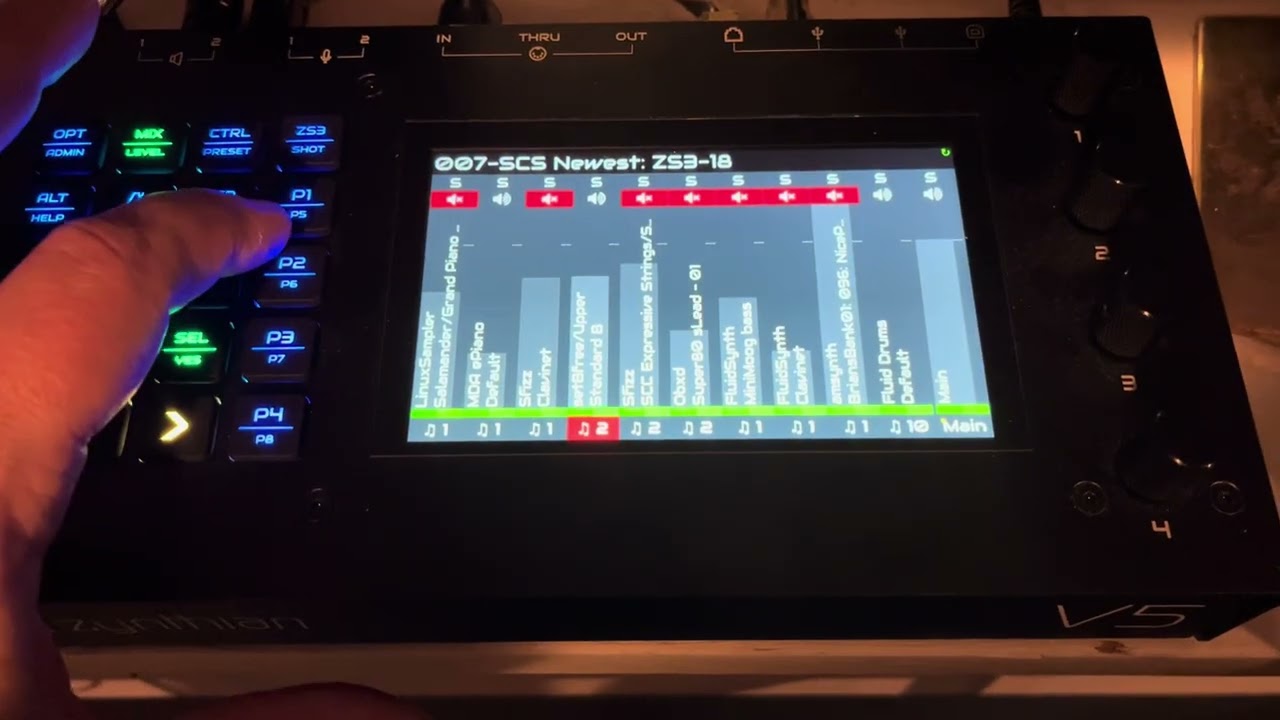

I am trying once again to figure out why zs3s load with mixers on certain channels set to the wrong volume (either 0 or 100) when invoked by MIDI program changes sent by my iPad using ForScore over a DIN-5 MIDI cable. The same zs3s load normally when called by the zynthian directly. This only occurs when I am using my iPad.
I have attached my latest zss file exhibiting this behavior.
007-SCS Newest.zss (1.5 MB)
The problem most often occurs when loading the zs3 labeled “The Truth” (0/29). The 9th chain in mixer order from the left, “am synth BriansBank01: 096: Nice Poly 12”, should have a volume of -9.90 db, and it does when I load it from the Zynthian UI directly. When I load it by sending a program change of 31 from my iPad over the DIN-5 MIDI cable, the volume shoots up to 100% (0.0 db).

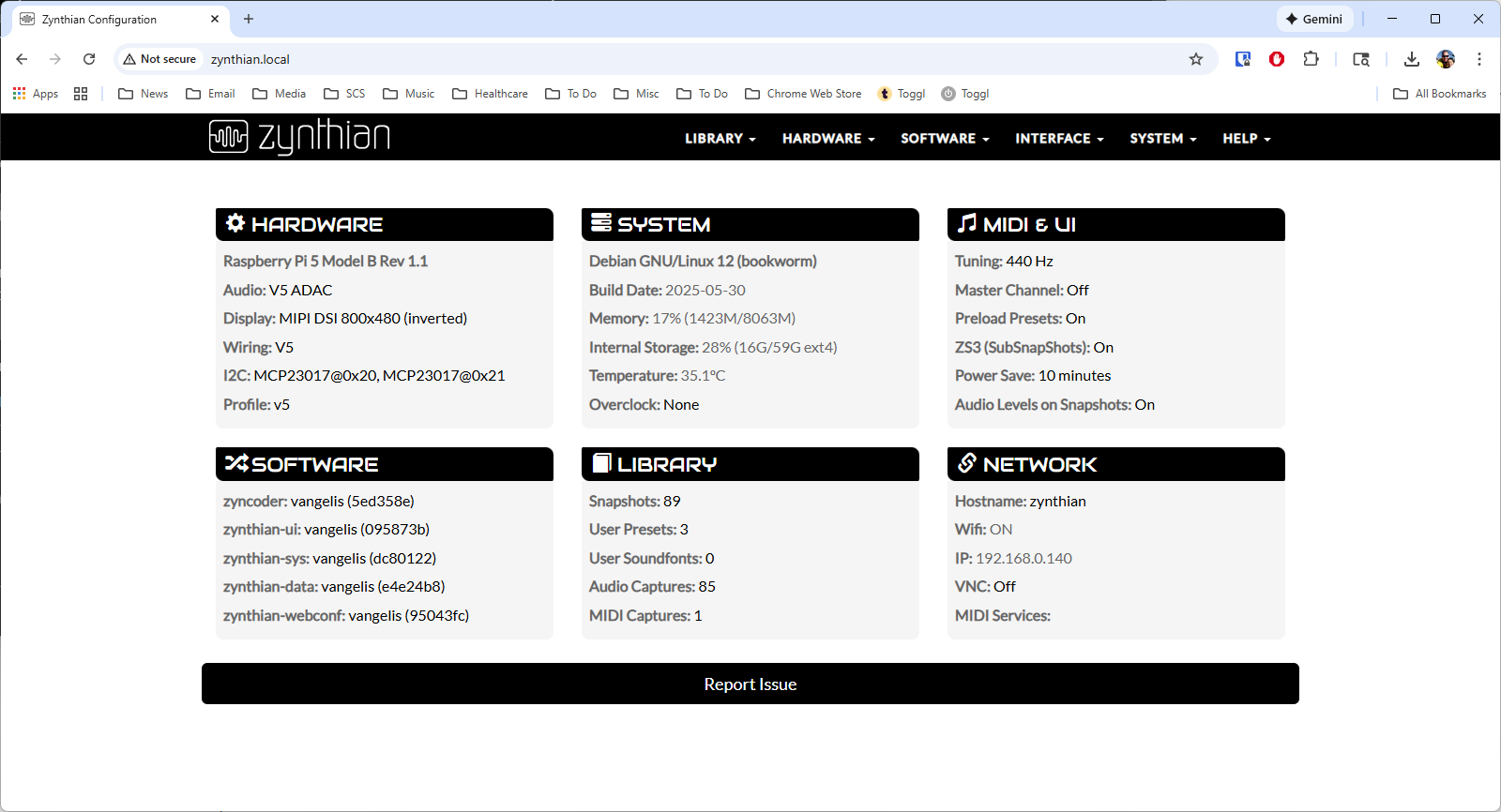

I have spent many hours troubleshooting this. I am using the Vangelis build, which I have otherwise found to be the most stable setup. Here is the web conf showing all of my configurations:

I tried the new cable and it exhibits the same behavior as before, setting the volume of chains 9 and 10 to the maximum volume. If I reselect the zs3, the volume of chains 9 and 10 go back to what they should be.
I’ve noticed now that once this behavior occurs, I also get the same behavior when I select the zs3s with the mapped F1 and F2 buttons on the Zynthian. I’ve created a video demonstrating the issue:
This therefore looks to be something that has to do with how the zs3 is loaded by the Zynthian, not related to how the iPad is sending the signal. Somehow, on the initial load of the zs3, the chain volume levels are being set either to the maximum or to zero. Performing the load a second time sets the volumes to their normal levels.

Are you sure your zynthian is updated? How old is your SD image? Are you using latest SD image? A screenshot from webconf dashboard could help.
