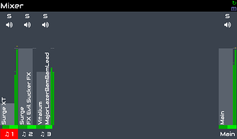

I did a little stress test. I tried the Ambien jam on the Torso T-1. One line led to Vitalium, where there was a preset with bass. The second line then played in Surge XT. I switched presets through the native GUI. There will still be some that generate a lot of XRUN. I would say that there are about 1/3 of them. And at the same time I was wondering like you how it will move with Pi 5.
The strength of Surge XT is precisely in those presets, that’s why I also published the install.log to see what the installation added. I will be happy to help prepare a complete package for easy installation in Zynthian. Only you, the more experienced, have to guide me. At least from the beginning. Surge XT releases a new version once every six months, which is an interval that would not burden me with compilation.

@jofemodo It’s been a couple of days now since I tested surgeXt and can confirm it works great! Unfortunately the presets are not loaded in the Zynthian UI but they work great when changing them from the VNC UI
So it seems we need to regenerate our LV2 preset collection for surgeXT. I nice work that must be done with love and care. I have the shell script i used last time and perhaps some volunteer could stepforward and catch the task
Indeed, we have the tracks from the first time we did;
An important point is regarding how parameters are managed by the LV2 generated. They jumped to JUCE 7, that support natively LV2, but they doesn’t use “control ports”, that currently is the only interface zynthian supports. Could you tell how many parameters are accessible in the zynthian UI?
