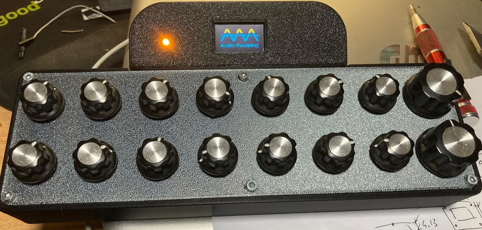

I can’t find the discussion about my MIDI controller for SWAM anymore, so I’m posting a photo of the V2 controller here. It has 16 controllers: 8 for the wind instruments, 6 for the strings, one for volume, and one for the effects mix. It also has a jack socket for connecting a pedal (ex volume) that controls expression. The onboard LED stays solid if no controls are touched, but flashes when any settings are changed. I’m thinking about the V3 version with encoders instead of potentiometers..

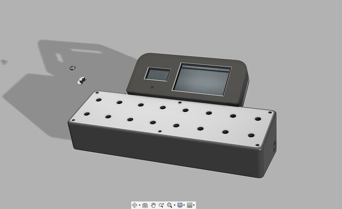

For fun and to study 3D design, I’m modifying my MIDI/USB controller. I’ve added a second, larger OLED display where I’ll always have the 16 controls in view, while the smaller one will only show the Expression pedal’s value. Later, I’ll replace the potentiometers with encoders. When I install the encoders, the controller will read the position of the controls on the VST and show them to me on the display.
The SWAM controller V2 is in the works.

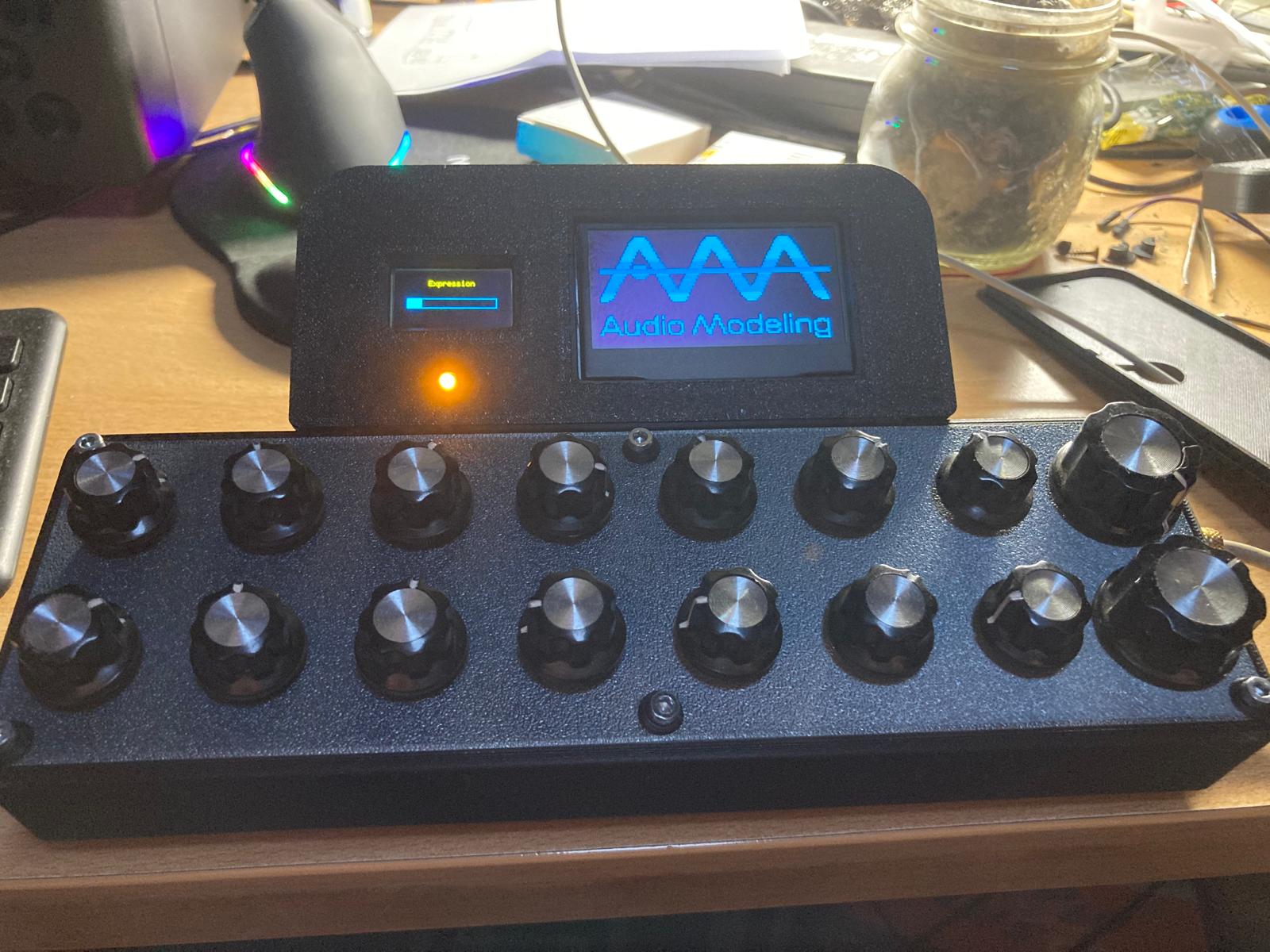

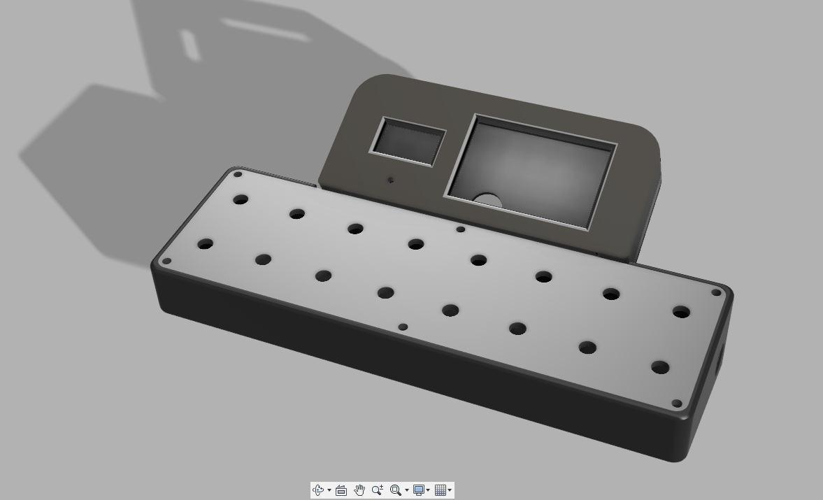

Here’s the first step… inserting the display that shows the controls and on the small display it only shows the Expression pedal… The next step will be to replace the potentiometers with encoders…
Contenitore.stl (255.8 KB)
Monitor.stl (135.7 KB)
Mascherina.stl (198.3 KB)
Coperchio monitor.stl (74.3 KB)

I use it to (for the wind instruments) add growls or modify the vibrato… or at least to modify the many controls that SWAM has without taking my hand off the black and white keys (yes, I still use the old black and white keys :rofl: :smiling_face_with_three_hearts: ). Now I’m assembling this controller with encoders instead of potentiometers… it works perfectly with potentiometers too, but I like to study… I’m getting help from the AI ​​for the sketch. In the second version, I’ll use a Teensy 4.0 instead of the Arduino Pro Micro. The Teensy has more pins and three i2c ports to connect the two OLED displays, each to a different port. Having two displays in parallel with different addresses slowed down the Pro Micro a lot.
