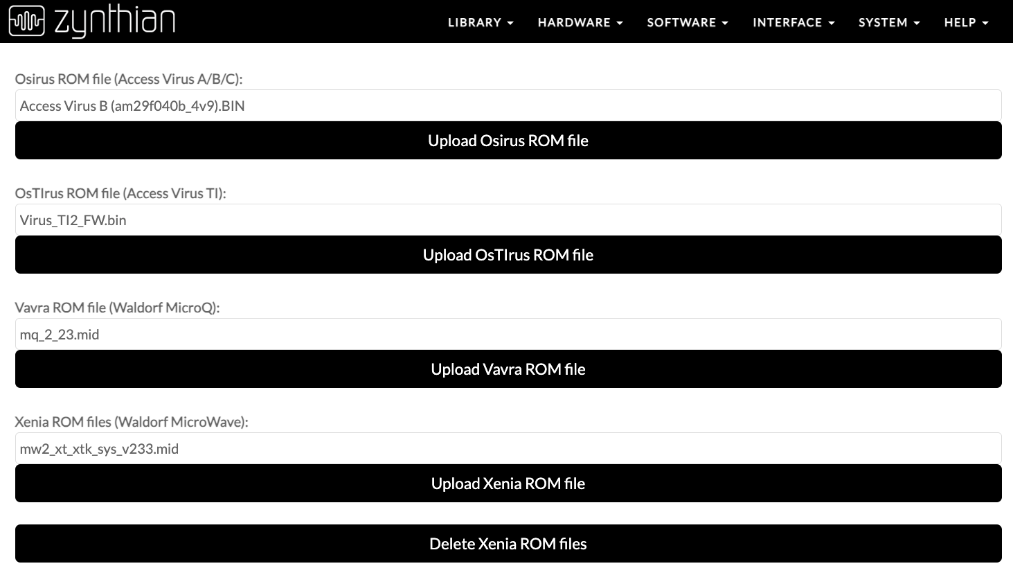

Hi guys…just built my new V5.1 and enjoying it very much.
I wanted to try the US DSP plugins on it but i get mixed results.
The two Virus engines work fine, but neither Xenia nor Vavra show any signs of life.
I tried older ROM files, the one i am using on the Mac, and also the official ones from the Waldorf site.
I started in ORAM, then ugraded to Stage and then Vangelis.
I can upload all files in the webconfig but when i load them into the chain they are empty.
What am I doing wrong ?
Is there some setup that i missed or doe the ROM files look wrong ?
Hi @ArguZ,
I recommend making sure that you have uploaded all the required ROMs, in .mid format: don’t remember which of the two emulators requires a set of more than one firmware file of the same kind.
Furthermore, don’t overlook enabling the new engines in webconf>engines, checking the related boxes. Afterwards, you should perform (top right of the screen) the ā€œsearch for enginesā€ and ā€œsearch for presetsā€ operations.
Also, please remember that any direct mention of procedures facilitating the installation of the emulators should be avoided, since their legal use is exclusive to owners of the original hardware, who know how to source and install the required firmware files.
Thank you :slight_smile:
All best regards

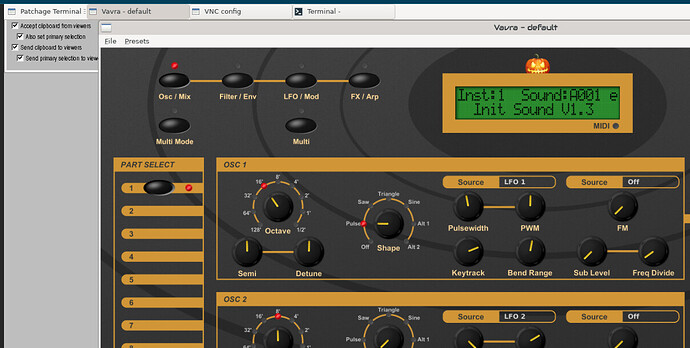

Have you checked, once enabled Vavra and Xenia on webconf, if they show on an external computer screen, if you switch on the VNC virtual desktop service on your V5.1?
Otherwise, it feels like some kind of system issue. For how painful it may be, did you consider re-flashing the OS to the latest Oram (and sticking to it while installing the emus)?
Now THAT is interesting…
After opening VNC i found both plugins and a welcome screen that i had to click away.

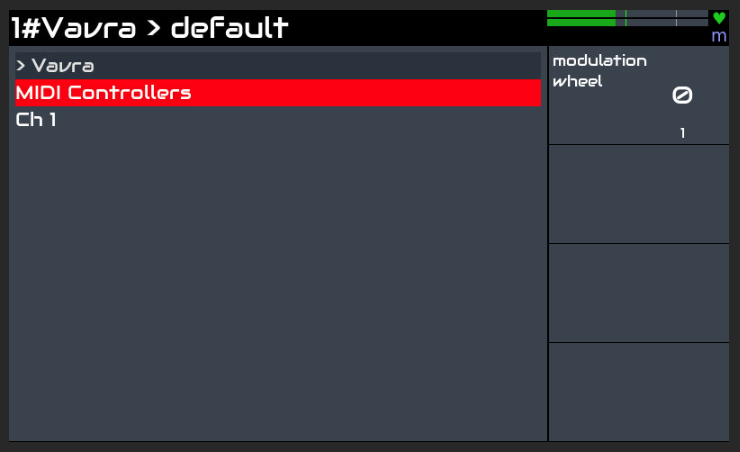

After that the engines make sound and I can use the UI on the desktop.
On the Zynthian it still shows only this…no controls…but midi input works and it sounds as it should.
I am up for reflashing, no problem…I was under the impression Vangelis was needed for it.
Wait, don’t re-flash!
This is exactly their expected behaviour as of now, because Vavra and Xenia do not expose parameters and patches yet to Zynthian (as an inherent limit of their current coding implementation on Arm 64), and therefore their processor’s editing pages look empty on the V 5.1 GUI.
So, as long as you can select, play and program/save presets on VNC, this is everything you can get within the Z ecosystem for the time being.
Regards :slight_smile: (and have fun with these fabulous synth emulators!).

I used to know but can’t remember… Where does the ROM upload service currently place the ROM files. Osirus, Ostirus, and Vavra are woking fine for me but no sound from Xenia. Just wanted to check that the ROM was in the right place. Another puzzle - why a Delete Xenia ROM option but no delete ROM option for the other synths?
Thanks,
Harry
Hi @harrylnorris :slight_smile:,
As of now and as far as I know, in the latest ZynthianOS implementations, all ROMs for the emulators should be found in a specifically named directory under:
root/.config/
Regards!
On my system (ORAM 2511 staging) they must be somewhere else. JV880 is there and a few other directories but nothing related to the 56300 emulations that I can find.
I’ll keep looking. I think somewhere in discourse ancient history it’s mentioned…
Harry
