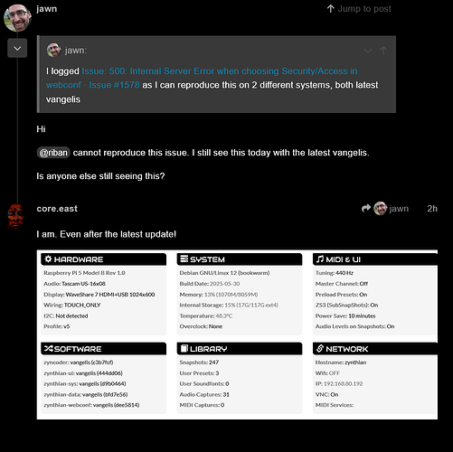

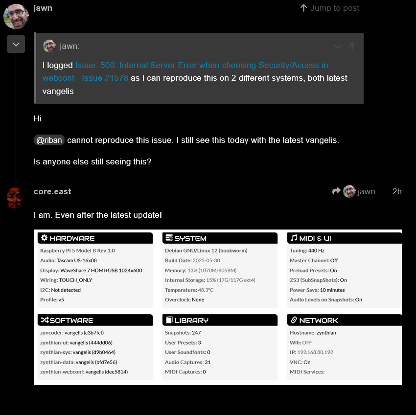

Same here still.
Hi
@riban cannot reproduce this issue. I still see this today with the latest vangelis.
Is anyone else still seeing this?
The Webconf > Security/Access page is alive again! (Update vangelis to enjoy)
Kudos to @multim for troubleshooting and @riban for the fix.
This helped to diagnose the issue:journalctl -fu zynthian-webconf

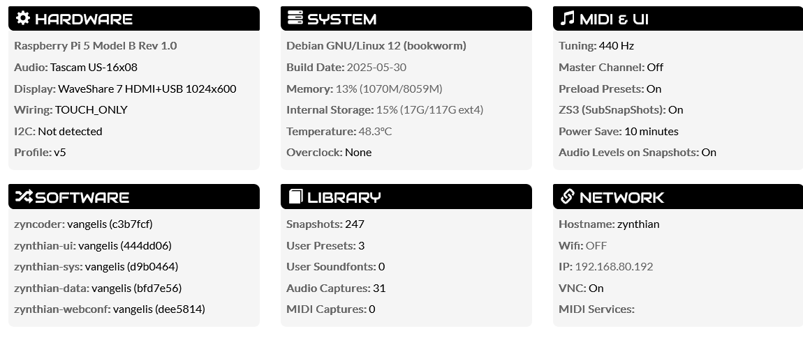

I am. Even after the latest update!
Hi @core.east , is there a part missing? I am sure you are but not clear what is happening for you.
I have hidden the public key stuff in webconf in the latest commit (a few minutes ago). This feature is not required yet - so no need to cause you hassle. Hopefully webconf SYSTEM->Security / Access page is working okay now.
Hi Jawn
  • the thing you asked :wink:
Thanks and sorry for missing my own question :sweat_smile:
And just checking if you have restarted the Zynthian since the update.
The issue with webconf security view is off topic and tracked in the issue tacker. Let’s move any outstanding issue with that bug to the issue tracker to reduce confusion in this thread.
