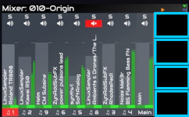

I renew a request of @philippejadin
for a better usability with RPi+touch screen only Zynthian, so for only touch interface, I think it would be fantastic to have in the main mixer window a column of 4 configurable buttons (as the 4 buttons of V4)
This should not be required. Zynthian UI is designed to fully support touch-only when “Touch Widgets” is selected from the “Touch Navigation” option in webconf INTERFACE->UI Options. The documentation (although incomplete) details this mode if you select “Touch” from the UI selector in the top right of the wiki page. All navigation and workflows are implemented. Please detail what issues you are having with touch-only UI. (I spent a lot of time trying to make this work fully so am interested to hear where my work has fallen short.)

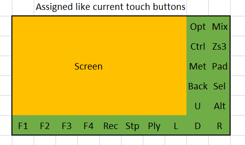

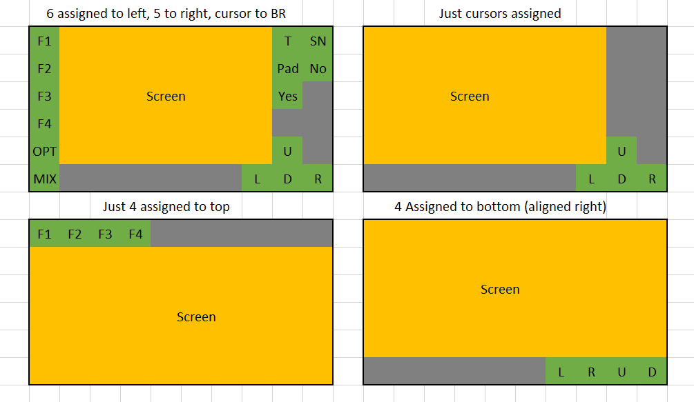

So the idea would be like this:
  • The underlying system stays the same. The wiring options stay the same, you’ll assign if there are 4, 20 or any other numbers of buttons. You’ll still state -1 for any virtual (touch/virtual buttons) or positive numbers for gpio buttons (v4/v5/custom).
  • The webconf wiring system would present a list of all possible actions, where the user assigns to each action a trigger event with seperate options: button #No; trigger duration [short/bold/long]; trigger type [touch/virtual button/physical button]
  • If trigger type “touch” is choosen, you get the choice which screen area to touch (title/status bar…)
  • If trigger type “virtual button” is choosen, you get the choice to which left/ríght/top/bottom panel a virtual button is appended dynamically.
  • The configured virtual buttons (if so) are appended in one line, if the number of buttons on a given panel exceeds the space, a second row is created. Cursor buttons will be automatically appended left or right bottom side like the current behaviour. The known controls are the basis of how the screen estate is used afterwards. The size of the virtual buttons can be user defined.
  • Up to three actions can be assigned to the same button #numbers for [short/bold/long]
That way you can abandon wiring layouts like V4/V5/virtual buttons/touch only completely. There could be preset layouts for most typically work cases (official V5.1 and so on) anyway. I think any official/common layout can be implemented like that as well as any custom setup. Let’s say you have a custom build with 8 additional buttons. You would assign them to physical controls, the other 12 you assign to 6 virtual buttons on the left and 6 on the right.
But again: I don’t want to stress the topic so much. I actually like the current layout and I just discuss about thoughts I have about the above mentioned request by @piattica and how it could be avoided to have different requests for additional touch buttons for different purposes by just making it configurable within the current system.
