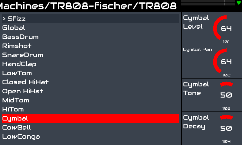

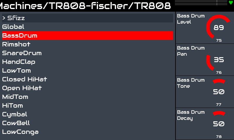

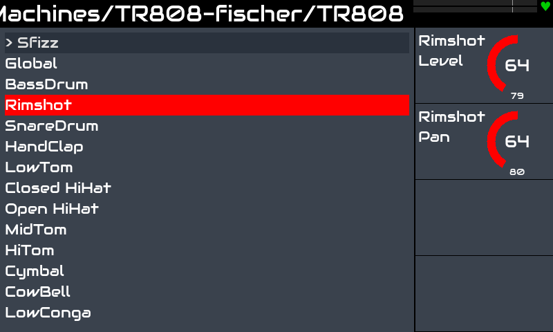

Hi drum machine lovers!
We have a new TR808 SFZ instrument based in the Fischer’s sample set.
The SFZ has been created by our @jlearman, that kindly accepted my proposal of writing a SFZ with all the sound controllers from the original device. He did it super fast and enlighten me about the way of (not) writing good and maintainable SFZ files.
Thanks a lot, @jlearman! I’ve learned a lot while adding the pan and level controllers. Indeed, i added some code to generate the zynthian YML file, that now includes the keymap too!. A PR is waiting for you in your repo.
The soundfont is available in my forked repo and also as a package for zynthian vangelis (don’t forget to update the package list with CTRL+F5).
etc.

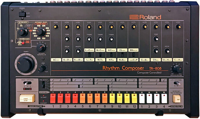

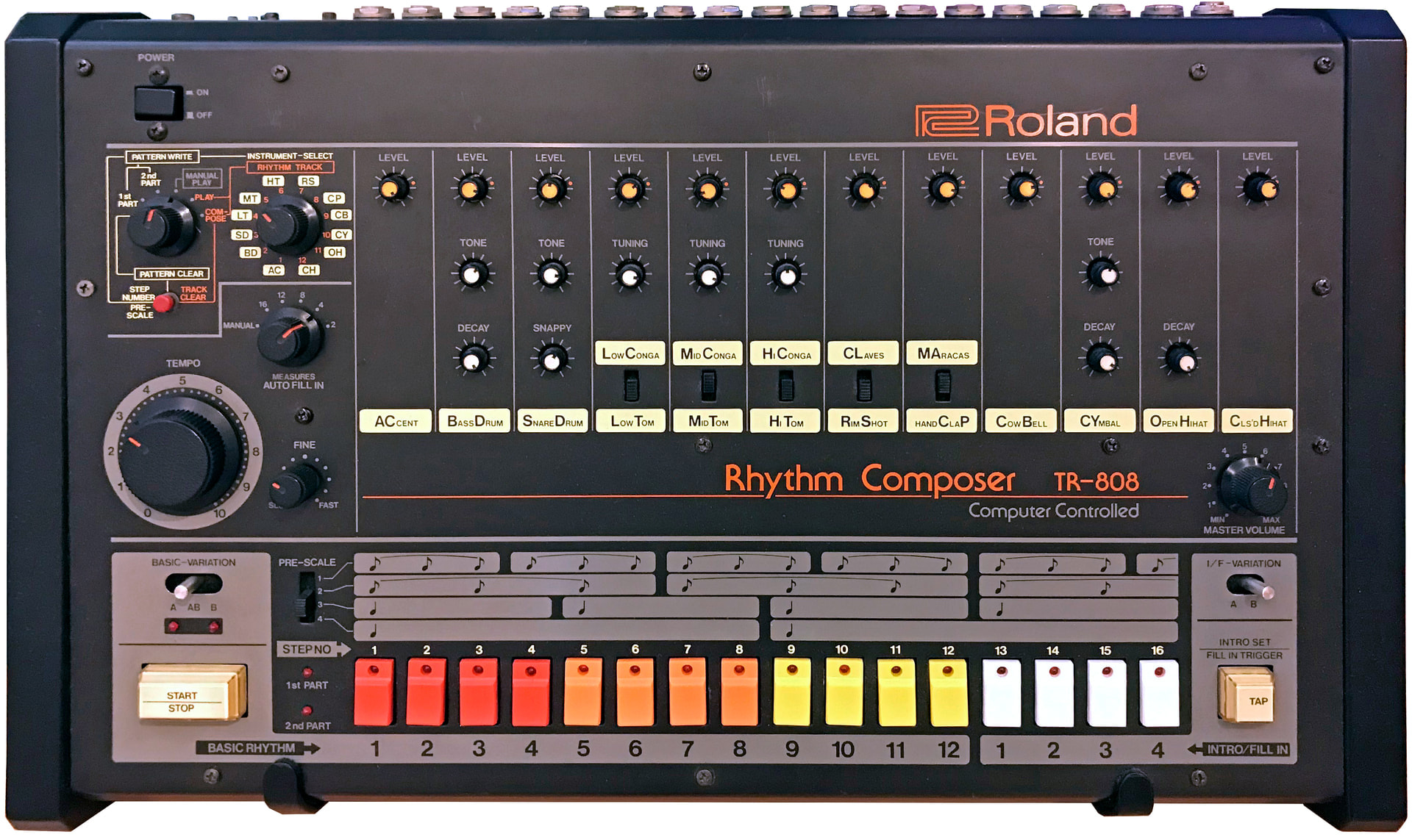

Sample-based Roland TR-808 drum machine emulation with all the sound controllers from the original device plus individual pan control for each sound. It uses the Fischer’s sampleset, composed of 116 high quality samples recorded directly from the original device at different control positions.
