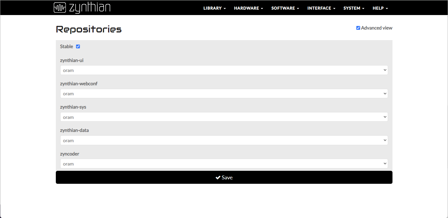

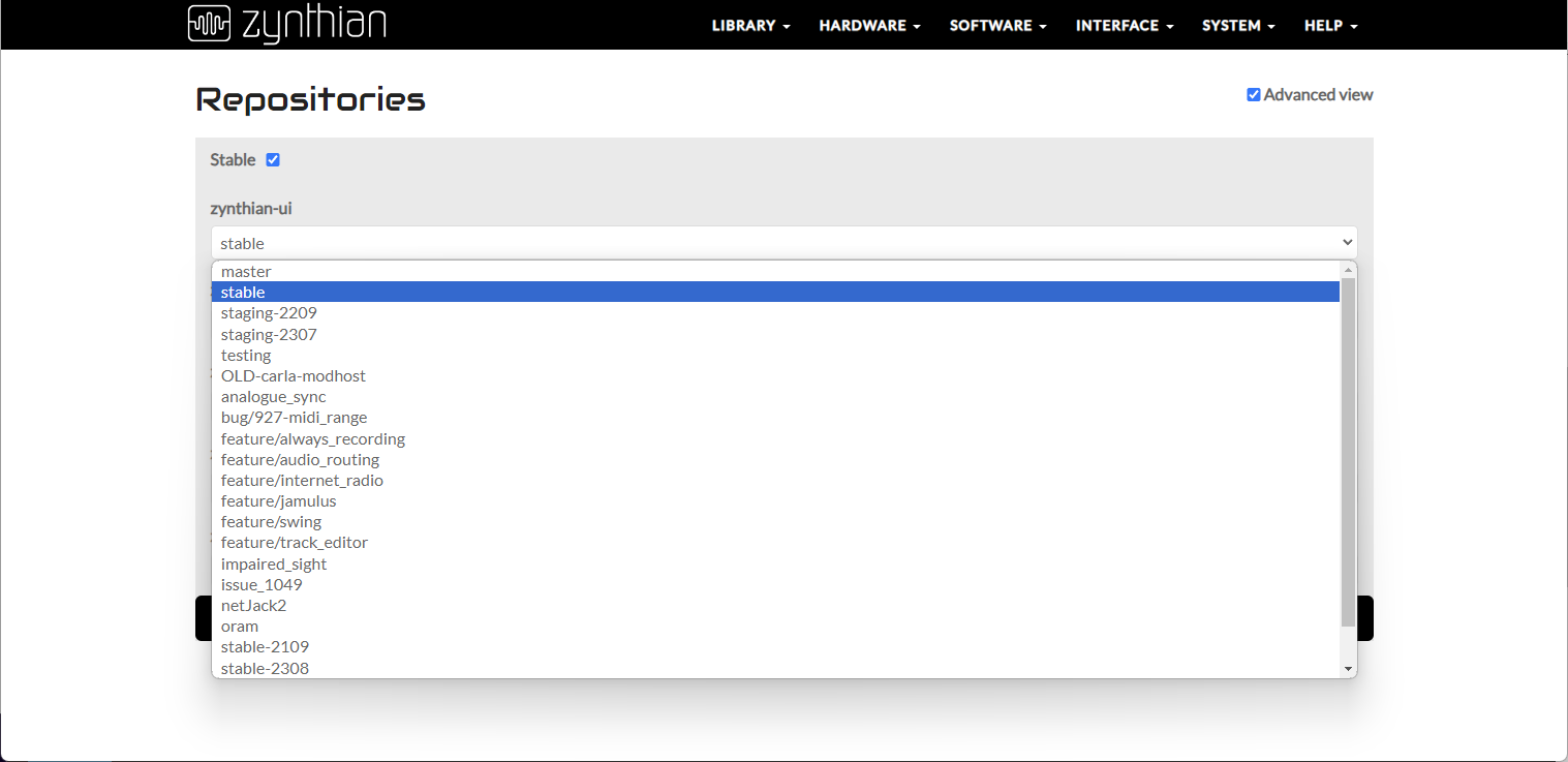

In case you were interested in how I was able to “upgrade” to Oram, here’s my steps to reproduce:
NOTE: DO NOT DO THIS!! IT WILL CORRUPT YOUR ZYNTHIAN BUILD!!
  1. Go to the web config (e.g., http://xxx.xxx.x.xxx).
  2. Select Software…Repositories.
  3. Check “Advanced view”.
  4. Uncheck “Stable”.
  5. For each category (e.g., “zynthian-ui”), select “oram”.
  6. Click Save.
  7. Select Software…Update.
