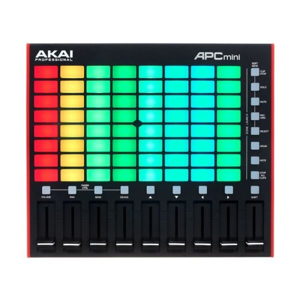

Will the Akai APC mini MK2 be supported in future? I tried to use mine with the zynthian but had no success.
It all depends on someone making the driver for it. I was just researching random stuff about color-schemes on the Zynthian when i stumbled upon the MINI. It is very tempting to order one, and maybe it would be a sort of entry into the business of ctrl-drivers and contribution to the community.
I think i understand a little bit about what Riban and Oscaracena discusses in this thread about some sort of higher ground for ctrl-drivers that some specific controller can utilize. But i think with my limited knowledge and poor stamina in these matters, i would need the easiest approach to making a controller driver.
@Riban @oscaracena is it more or less correct to assume that if i buy the Akai APC Mini, and start of with some sort of copying from the Akai APC Key25 driver, and giving that i would persevere and become a sufficient ctrl-driver programmer, it would be possible to get something not to far from @oscaracena’s sequencer part of the Key25 functionality, and the mixer working for normal channel mixing?
I (am learning to) use the Akai APC Key25 on my TravelZynthian. But at home i use a Studiologic SL73 and my homebreewed Zynthian. I can really see the Akai APC Mini fitting very well into that. Of course there are no knobs, but i guess that one could use the faders to adjust specific parameters for specific steps / specific instruments.

What I would do if I had the mini, is to further abstract the apc key25 mk2 driver. Defining pads and knobs mapping which can be overwritten when subclassed. Same for rows and columns.
The midi messages to set the colours are identical.
For the faders I would use the methods defined in the apc key25 (first gen) driver, since these are absolute.
Then there is the ninth fader with which you’ll want to control the main outs.
And I think you can query this device on the actual fader positions, which can be nice to do stuff with.
And soft Keys that have no function yet. The documentation is vague about how exactly drum and notes mode are handled (the device? In ableton live?).
If you have no experience in Python yet simply copying and tweaking may be easier than subclassing.
