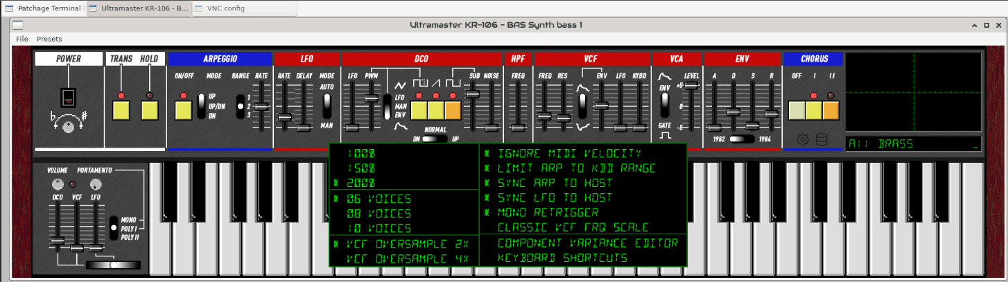

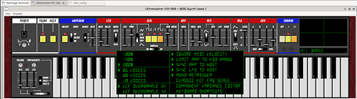

On the Zynthian side, it would be great to have the options parameters in the interface. Now they’re only available in webconf in VNC-Engines. One more thing… i noticed that the arpeggiator is not synched to BPM :face_with_raised_eyebrow:

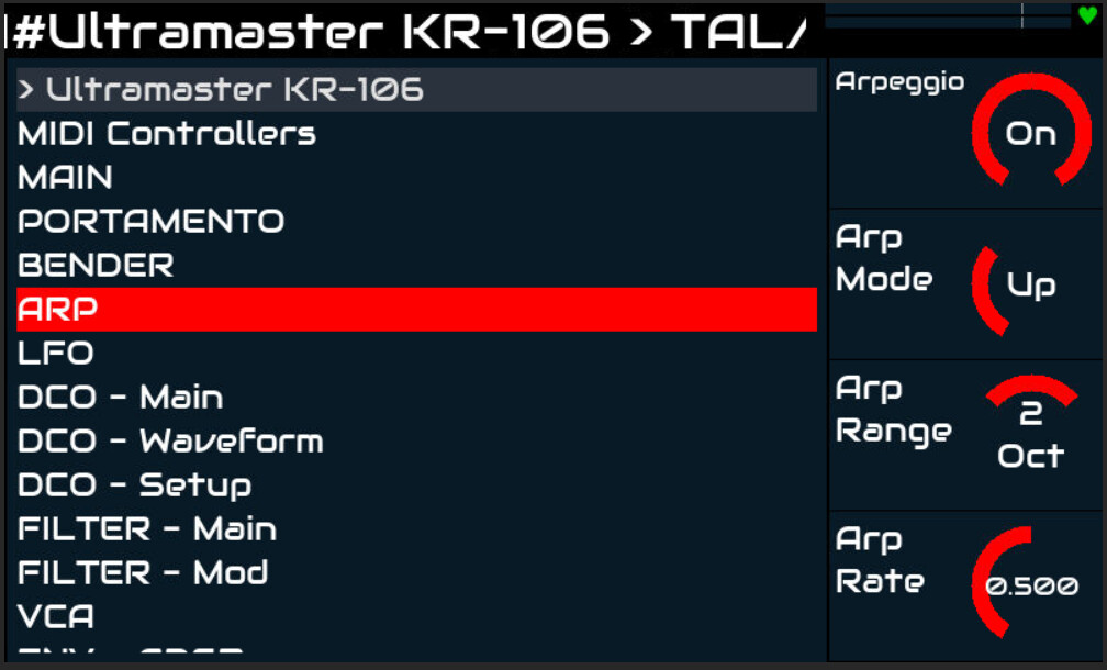

I have KR-106 working on my Oram staging, I can even build the updated source, but for some reason the custom dsp.ttl is not showing the synth parameters in the chain, just the presets. I already tried to delete the patchlevel.txt file and run all available update recipes, but didn’t fix it. Is there something I should attempt before doing a new SD image? Thanks a lot
If you manually installed then it is possible there are 2 instances and zynthian’s LV2 plugin host (jalv) will chose one which might not be the one that we support though the standard update. Do you remember the commands you may have run when you built it, particularly where you might have copied the lv2 files to?
I used the recipe script on zynthian-sys (btw, i fixed it and submitted PR), so all should be in the correct folders. But I will investigate that possibility, thank you.
I really want to understand this, it may be handy in the future to tweak other plugin parameters ttl. It’s the kind of contribution I can embrace.
I don’t exactly understand what you mean by this. Typically with every update zynthian copies custom ttls from zynthian-data/lv2-custom to the respective location.
It might be possible that with ne newer updates parameter symbols changed? That way the custom ttl would need to be adapted.
