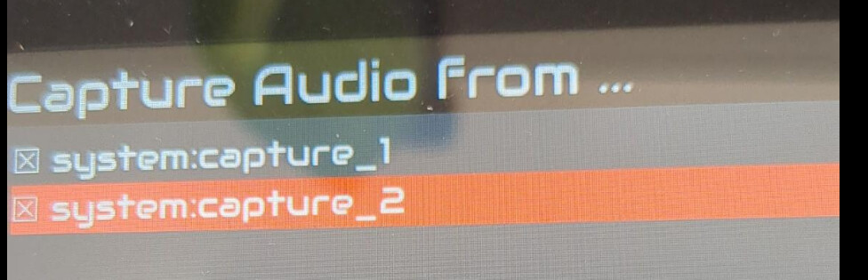

Since the topic is not too old and I was referred to this thread with the same problem, I’d like to provide some update:
At least Oram is able to recognise hot plugged USB audio devices.
  1. Pressing “Opt/Admin” a little longer opens the Admin menu.
  2. In the admin menu select „Hot plug USB audio".
  3. in the next level there is only one point “Hot plug audio”. If it is not crosesd, select it.
  4. It takes a moment until all devices have been recognised. Then, the found USB audio devices are added to the menu and can be selected for operation.
  5. Then you press “Opt” short again, in order to add an audio chain.
  6. The group “Audio Effect/Delay” allows to choose “None” as effect plugin (you can use any other plugin for processing the audio).
  7. After the chain has been added, it is possible to configure it to be recorded
