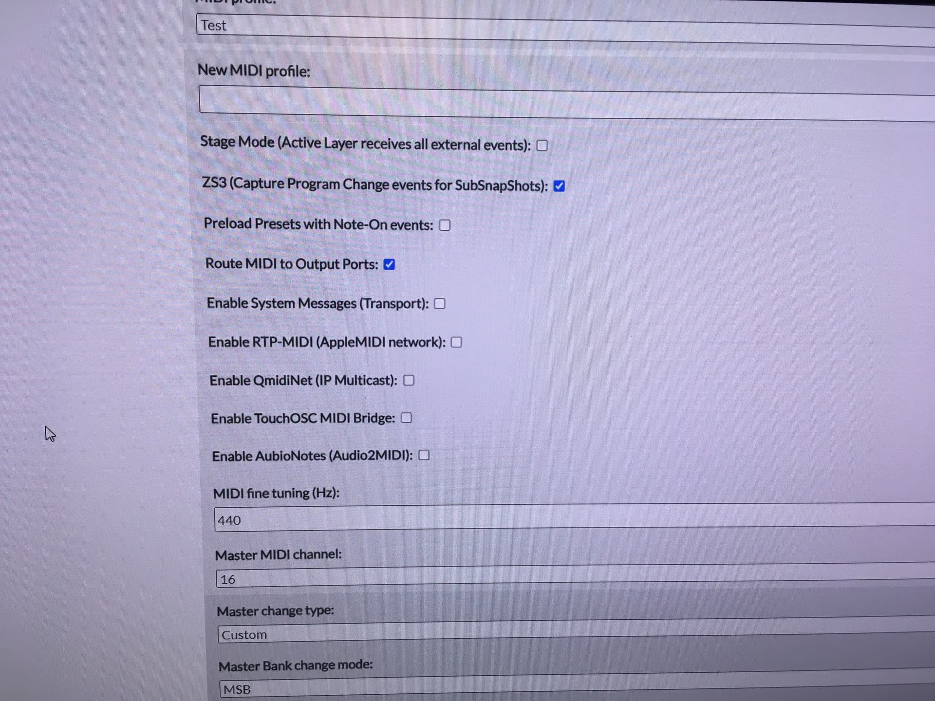

One problem that i have is, that i cannot get the input of the keyboard to be send out via the midihub. I know, thta it is possible to do this with the Zynthian and have done this before with a different setup. So maybe its the midihub, or i am too stupid to find the right settings (for there are quite a lot). Maybe someone can help me with this problem. I put some pictures i made in the rehearsal room below, maybe this helps.

it must be a problem of zynthian routing. if i look in the zynthian midi log i can see the midi input from the arturia keyboard, but it is not sending the informations out to the midihub. If i send something to midihub DIN input the zynthian is getting the informations right. Just the output from zynthianis not working.
also i dont really understand the differnce between the midi out and the midi feedback ports of the zynthian.
