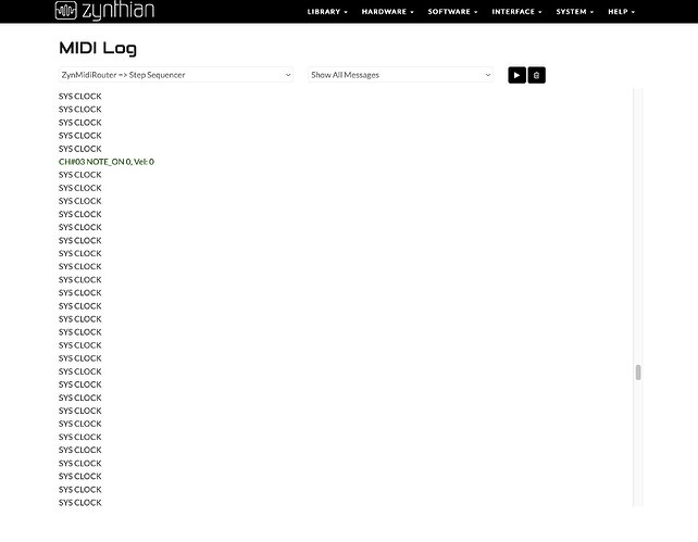

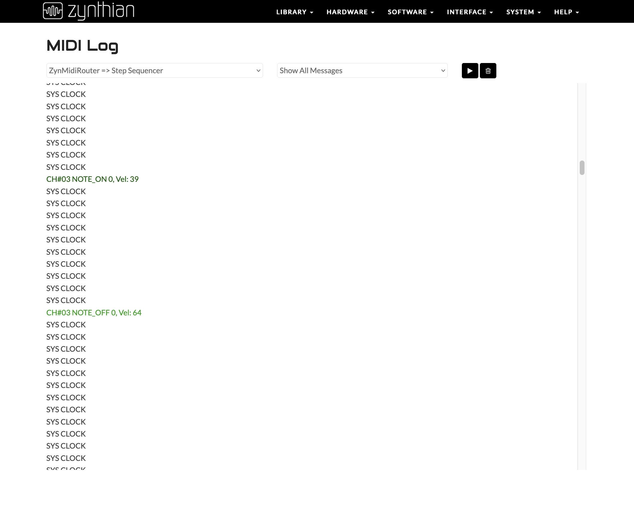

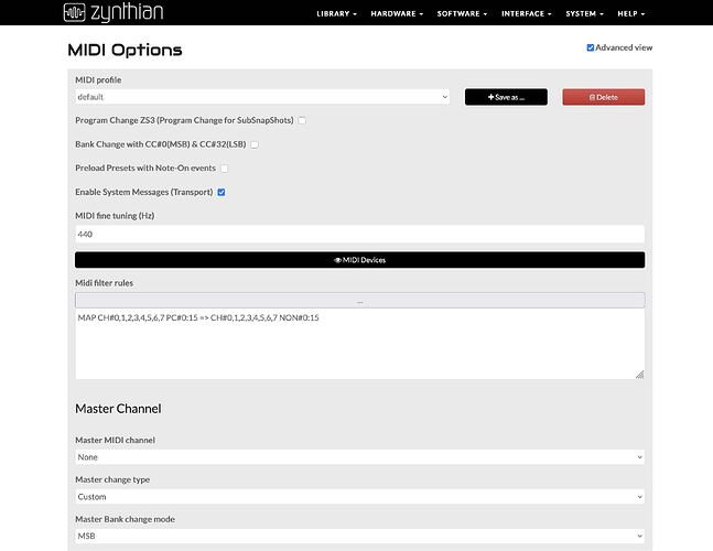

Ok, cool I finally had a chance to play around with this on the hardware. I’ve had some success, but some issues also.

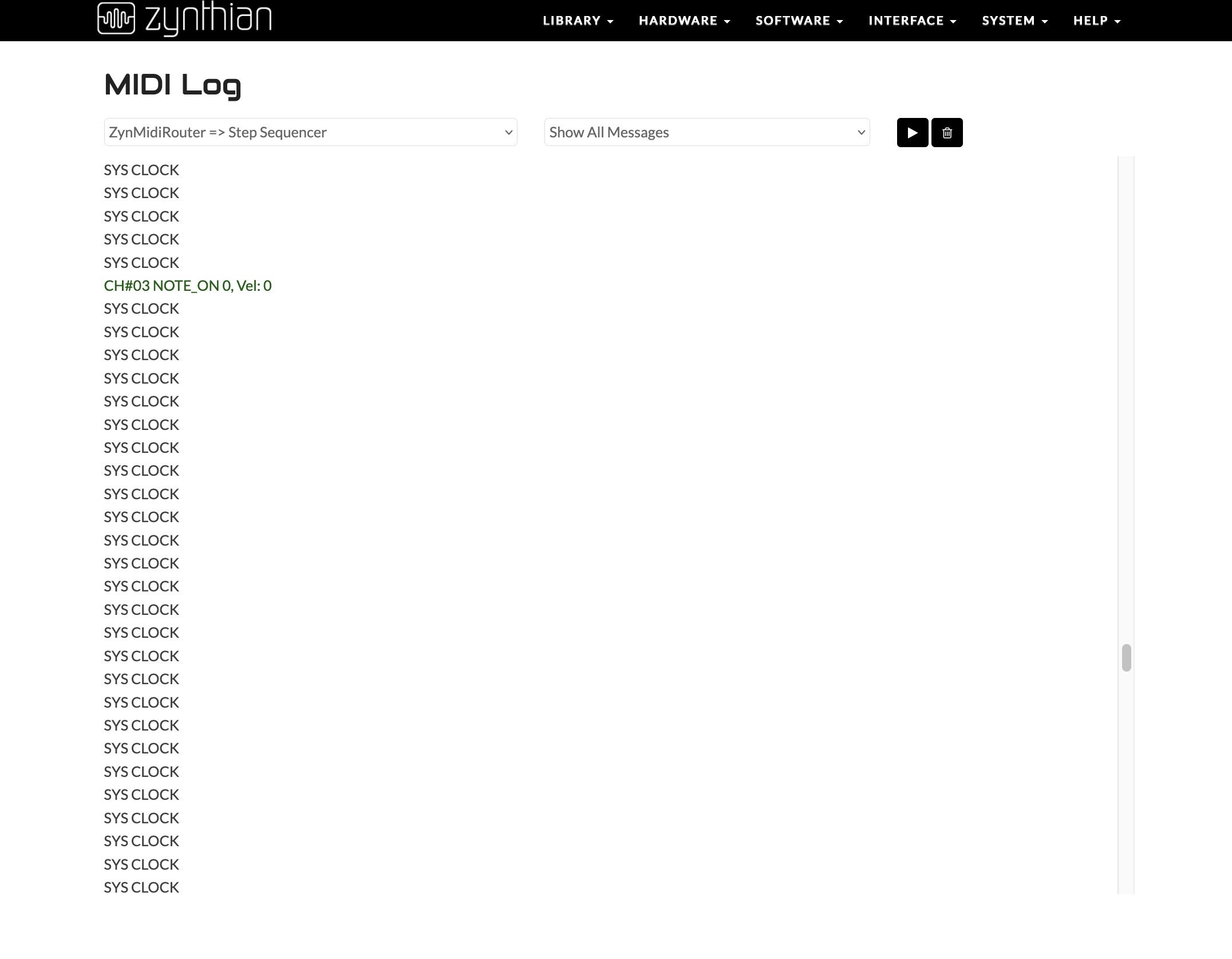

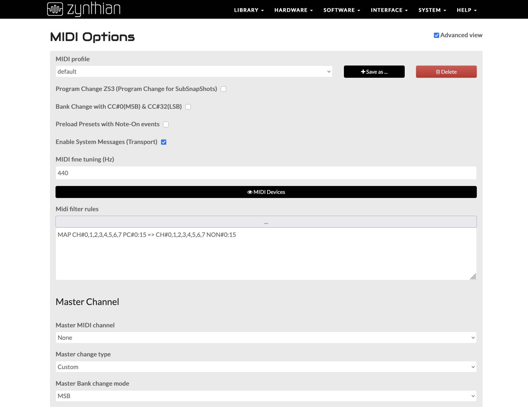

1. In my best case scenario, I would be able to trigger a sequence in ZynPad with a program change message from the MC707. I am able to get a sequence triggered from a MIDI Note message from the MC707, and I’m able to add a MIDI filter to map program change messages to note messages. However, those notes don’t seem to trigger sequences on ZynPad at all. I can see them in the MIDI log, they come through as velocity 0. Is this perhaps the reason, ZynPad doesn’t recognize velocity 0 notes as triggers? Is there a way to map to note-on with a particular velocity? Here’s the filter:
What I get when sending a PC from the MC707 (doesn’t trigger ZynPad):
What I get when sending a note from the MC707 (this does trigger ZynPad):

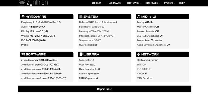

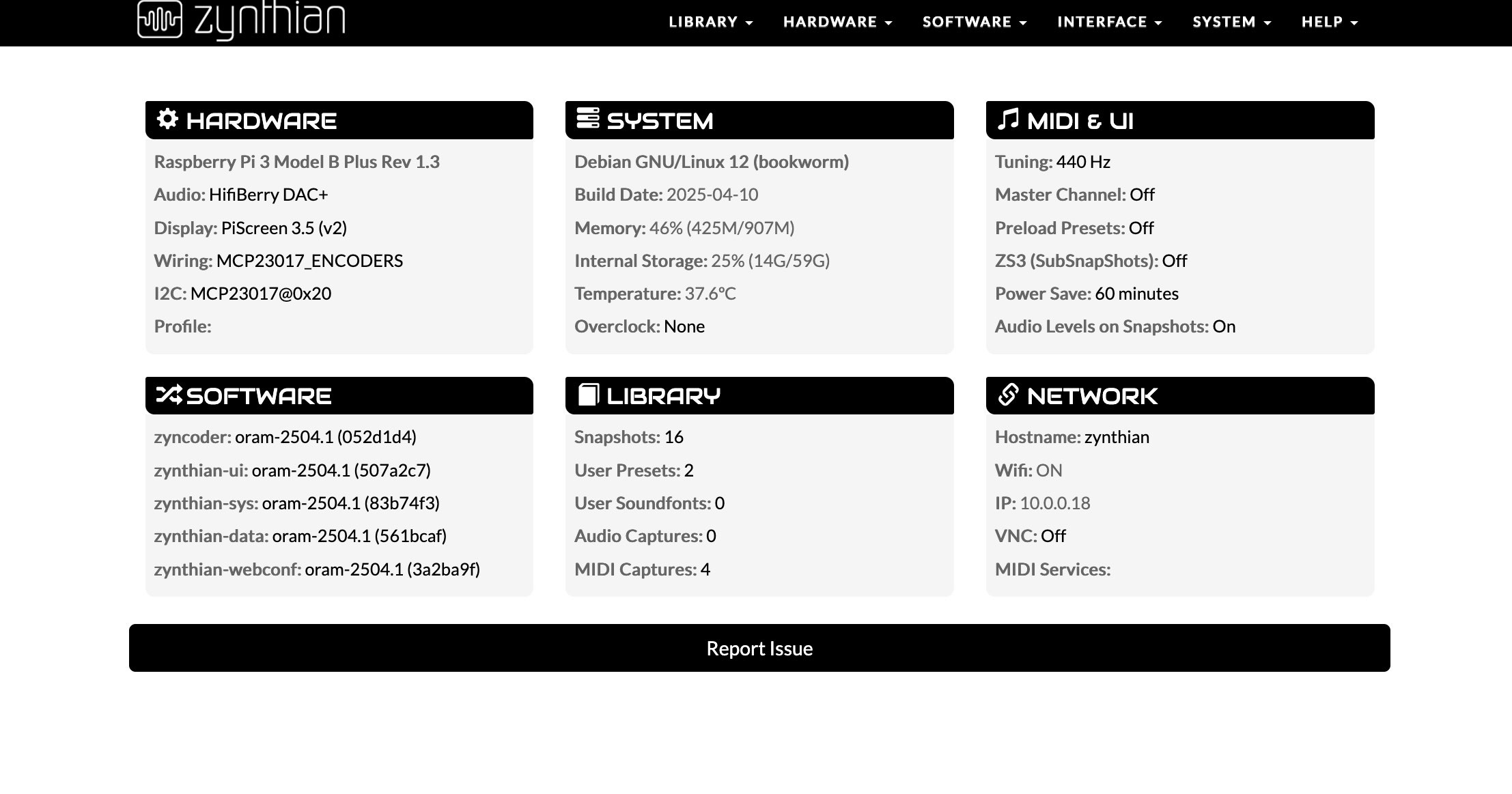

Here’s what I’m running:

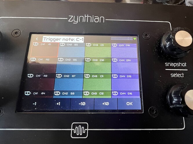

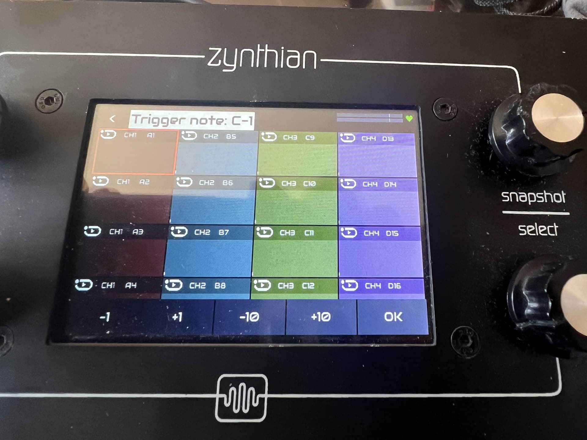

3. There’s a weird UI thing assigning MIDI triggers to pads. When I’m selecting a note with the encoder on this screen:
If I ‘roll over’ a note (ie, I’m rotating the encoder, but haven’t pushed it yet) that has previously been assigned as a trigger for another pad, the trigger note will be removed from that other pad. This clearing from another pad makes sense, but this “clearing-from-old-assigning-to-new” process should not happen until the encoder is clicked. I can work around this, but it is pretty annoying :grinning_face_with_smiling_eyes:
