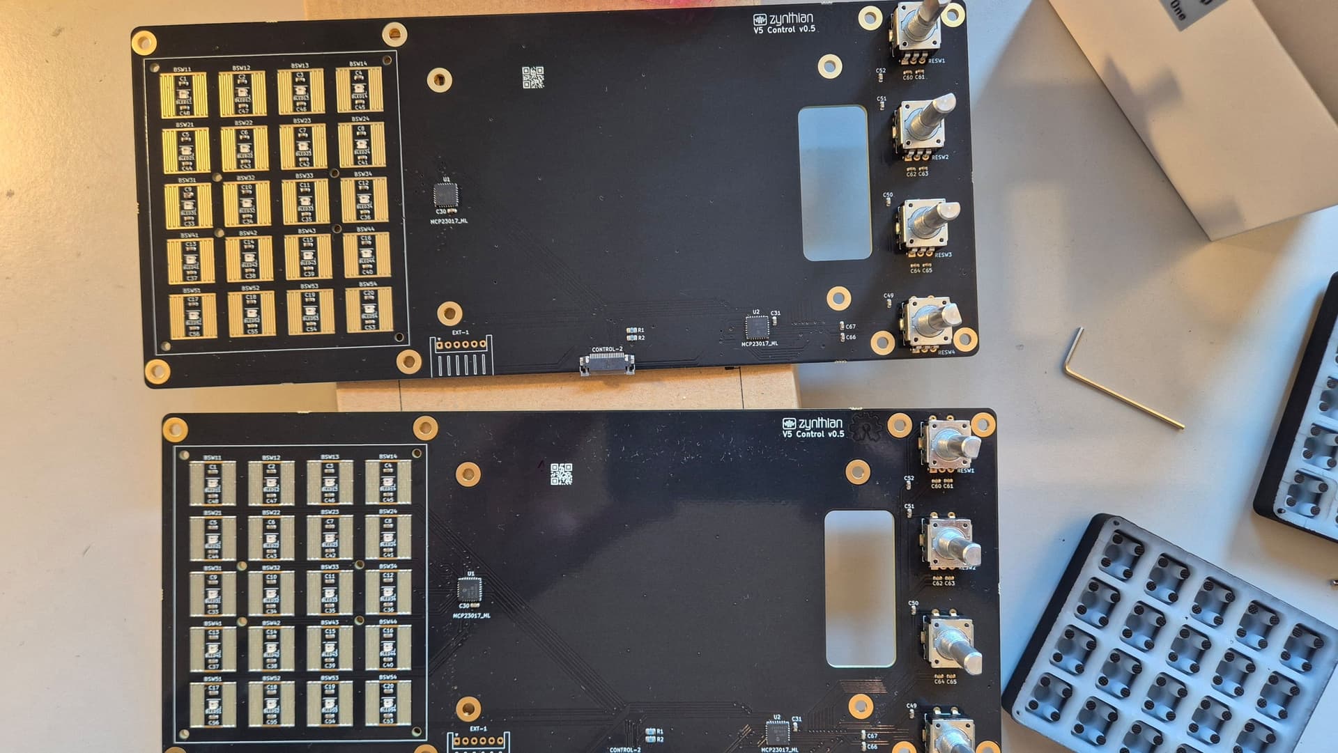

I got the board, performed the replacement, and I’m happy to report that the response is much better!!
The difference between the two boards is clearly visible to the naked eye.
The new board is on top, old board on the bottom. Look at the contact surface. The upper one is golden and flat, versus the lower one, which is silvery and bumpy. Interesting defect.
Now the buttons respond perfectly! Thanks again for the replacement!
