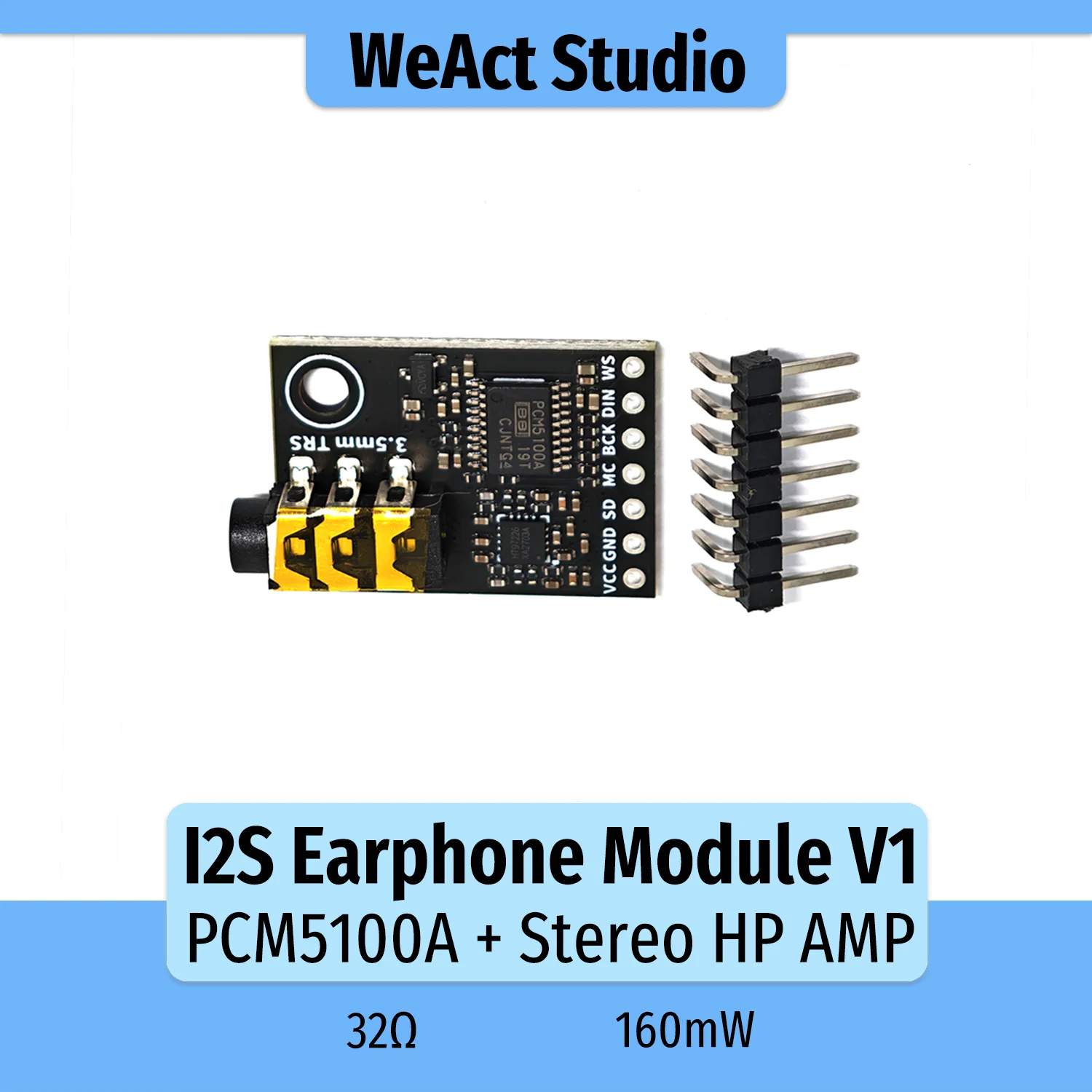

Do you think it would be technically possible to integrate this device into the official kits, it’s really cheap and compact.
Or is it not possible to have two I2S devices ?

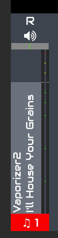

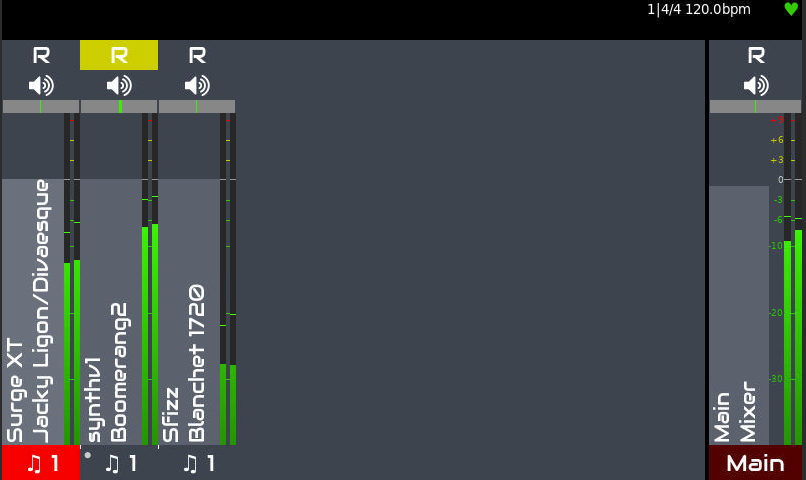

Is “SOLO” no longer working?
It is perhaps not a good sign that the “S” above the column has been replaced by an “R”, but the device’s help function still lists Solo. However, it does not work.
The presets can only be selected via VNC, selection on Zynthian itself shows the new preset, but it still plays the init patch.
By default, strip “solo” toggle has been replaced by “record arm” toggle. But this is now configurable, so you can config the solo toggle or any other mixer toggle to be placed in the strip top position. You can do this from the admin menu. easily.
