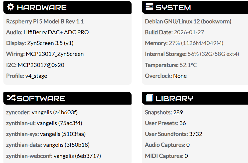

Vangelis on V4 customized with RPi5 and after latest updates:
Loading snapshots prepared in Oram I have strange behaviours.
For example: my default snapshot (2 chains: Pianoteq + VirtualJV) generate this:

sounds correct but after some minutes Zynthian gets stuck: impossible to operate with encoders or buttons and if I try rebooting by Webconf sometimes there is an Error on screen
other snapshots stuck Zynthianor sound different because load different presets
