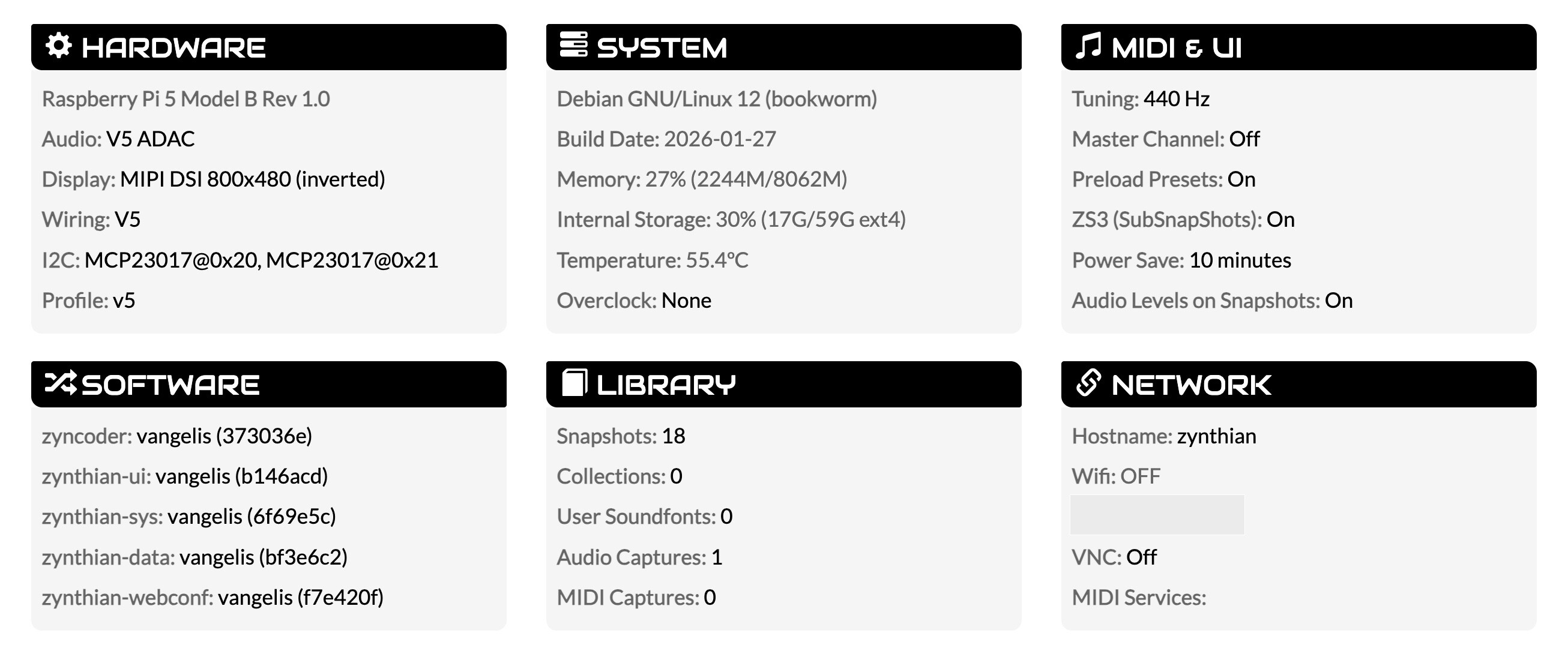

Tried to update today and got Error software 405
Is this a known thing, or am i unlucky?
sys and debug log

Jul 03 16:55:45 zynthian startx[122963]: Traceback (most recent call last):
Jul 03 16:55:45 zynthian startx[122963]: File “/zynthian/zynthian-ui/./zynthian_main.py”, line 48, in
Jul 03 16:55:45 zynthian startx[122963]: zyngui.create_screens()
Jul 03 16:55:45 zynthian startx[122963]: File “/zynthian/zynthian-ui/zyngui/zynthian_gui.py”, line 485, in create_screens
Jul 03 16:55:45 zynthian startx[122963]: self.screens[‘help’] = zynthian_gui_help()
Jul 03 16:55:45 zynthian startx[122963]: ^^^^^^^^^^^^^^^^^^^
Jul 03 16:55:45 zynthian startx[122963]: File “/zynthian/zynthian-ui/zyngui/zynthian_gui_help.py”, line 67, in _init_
Jul 03 16:55:45 zynthian startx[122963]: super()._init_(zynthian_gui_config.top,
Jul 03 16:55:45 zynthian startx[122963]: File “/zynthian/venv/lib/python3.11/site-packages/tkinterweb-3.24.7-py3.11.egg/tkinterweb/htmlwidgets.py”, line 41, in _init_
Jul 03 16:55:45 zynthian startx[122963]: ttk.Frame._init_(self, master, **kw)
Jul 03 16:55:45 zynthian startx[122963]: File “/usr/lib/python3.11/tkinter/ttk.py”, line 710, in _init_
Jul 03 16:55:45 zynthian startx[122963]: Widget._init_(self, master, “ttk::frame”, kw)
Jul 03 16:55:45 zynthian startx[122963]: File “/usr/lib/python3.11/tkinter/ttk.py”, line 527, in _init_
Jul 03 16:55:45 zynthian startx[122963]: tkinter.Widget._init_(self, master, widgetname, kw=kw)
Jul 03 16:55:45 zynthian startx[122963]: File “/usr/lib/python3.11/tkinter/_init_.py”, line 2628, in _init_
Jul 03 16:55:45 zynthian startx[122963]: self.tk.call(
Jul 03 16:55:45 zynthian startx[122963]: _tkinter.TclError: unknown option “-on_link_click”

It looks like your tkinterweb module was not updated correctly.
Please, try to re-update like this from command line:
echo "20260608.1" > /zynthian/config/patchlevel.txt
update_zynthian.sh
and avoid WIFI for updates :wink:
Note that you can use this trick to force the update from the specified date.
thx. I’ve tried, but get this:
(venv) root@zynthian:~# echo “20260608.1” > /zynthian/config/patchlevel.txt
(venv) root@zynthian:~# zynthian_update.sh
-bash: zynthian_update.sh: command not found
Sorry, it’s:
update_zynthiam.sh
success, thx. U guys are great!
i will put this in my notes!
