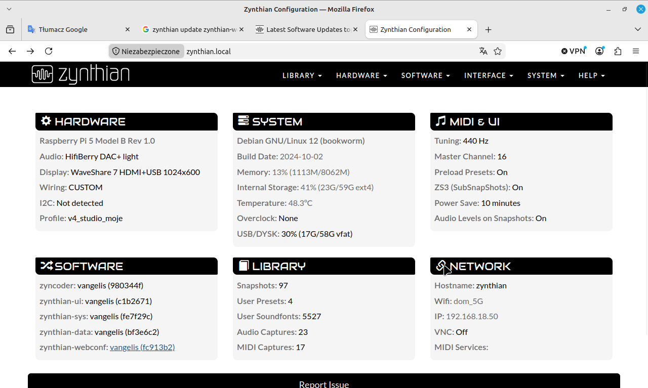

In the upper right corner, there is still an update available icon.
Can anyone help me solve this??
my configuration
