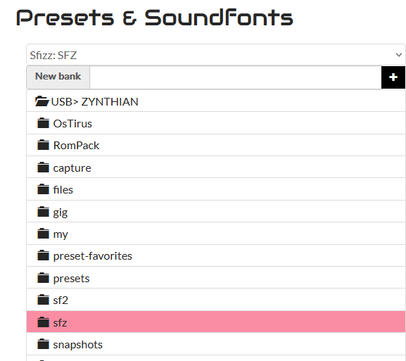

It shows up as usual in webconf but that is (and always was) unreliable for file management:

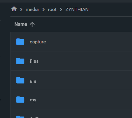

The webconf File Browser works fine, the drive shows up twice, once as /media/root/ZYNTHIAN and once as my-data

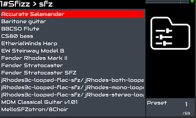

On the Zynthian itself I see no difference with the original situation:
