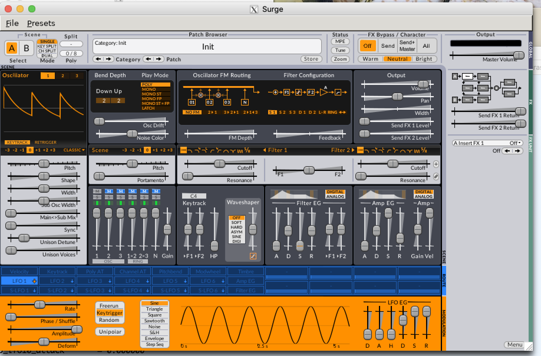

Ahd I don’t know what jalv -s does and when I run it I also don’t get a UI, I get a prompt. But
 jalv.gtk https://surge-synthesizer.github.io/lv2/surge
in an ssh -Y pi@raspberrypi.local session from my MBP with xquartz running gives me the attached.
Hope that helps!
