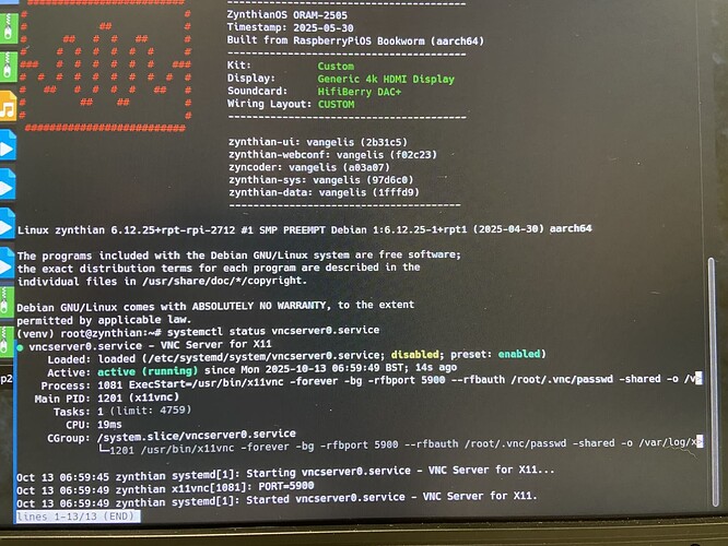

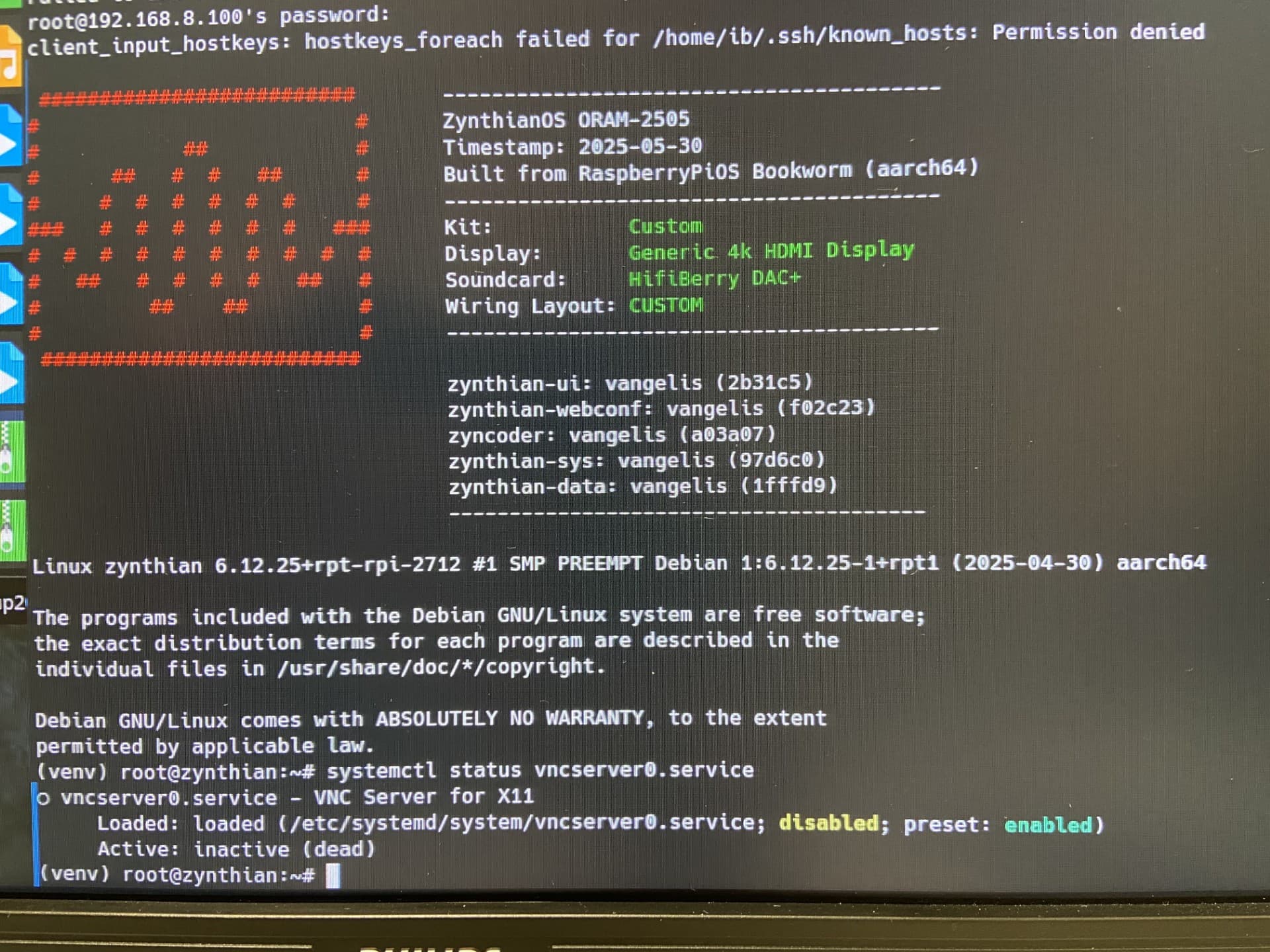

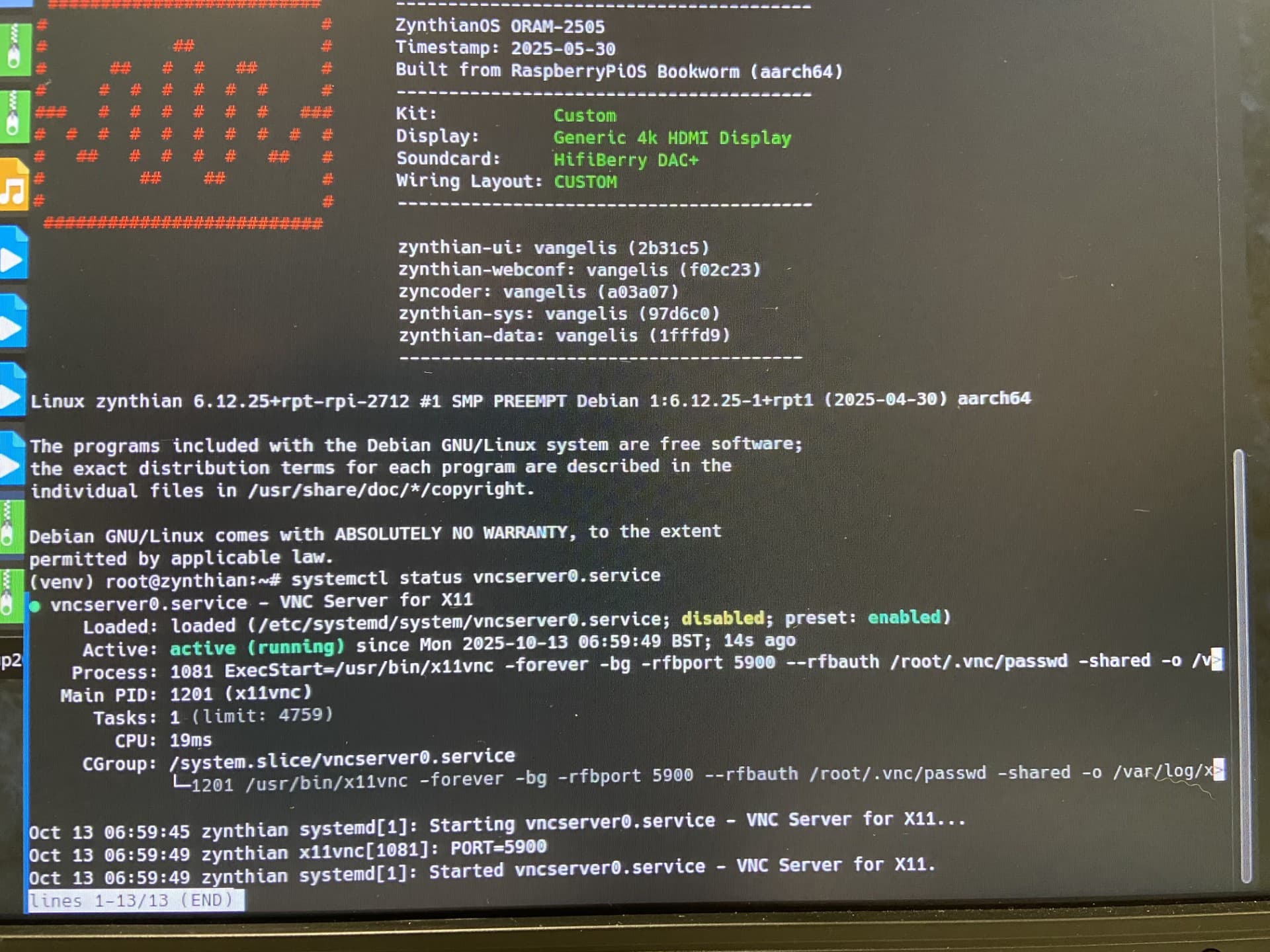

Hello, I can confirm that VNC only works when a physical screen is applied.
Status without physical screen connected:
Status with screen connected:
I veryfied this behaviour a dozen times.
Bye.
Thorsten
Please use webconf’s “Report Issue” button to add a ticket to the issue tracker. We will take a look.
You must configure HDMI display.
Cannot confirm this.
Neither chosing “Generic HDMI/DSI” nor “Generic 4k HDMI” nor “Custom Device” solves the behaviour.
Have you used the “WaveShare 5 HDMI+USB” configuration? (The name in webconf, not the actual adapter.) I had that setup when RPi5 was running headless.
I can gladly confirm, that choosing “Waveshare 5 HDMI+USB” as well as “Waveshare 7 HDMI+USB” leads to positive VNC-support.
