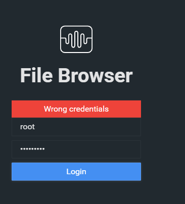

Hi all,
I am trying to login on the Webconf - file browser but get error ‘wrong credentials’.
I assume the root user should be used? The file browser seems to be missing in the webconf docs. I can update those once this is clear to me.
I verified the filebrowser service is started and running as root.
I triple checked for mistyping the password, even copy pasting from cleartext…

Any advice on what to check next?

The user is “zynthian”, not “root”.
Sorry, the default credentials for the file browser are:
user: zynthian
password: opensynth
We would like to unify and simplify the login process in the different services of zynthian, but it’s not so easy. It needs time and attention.
Thanks, this works! Added to the wiki.
