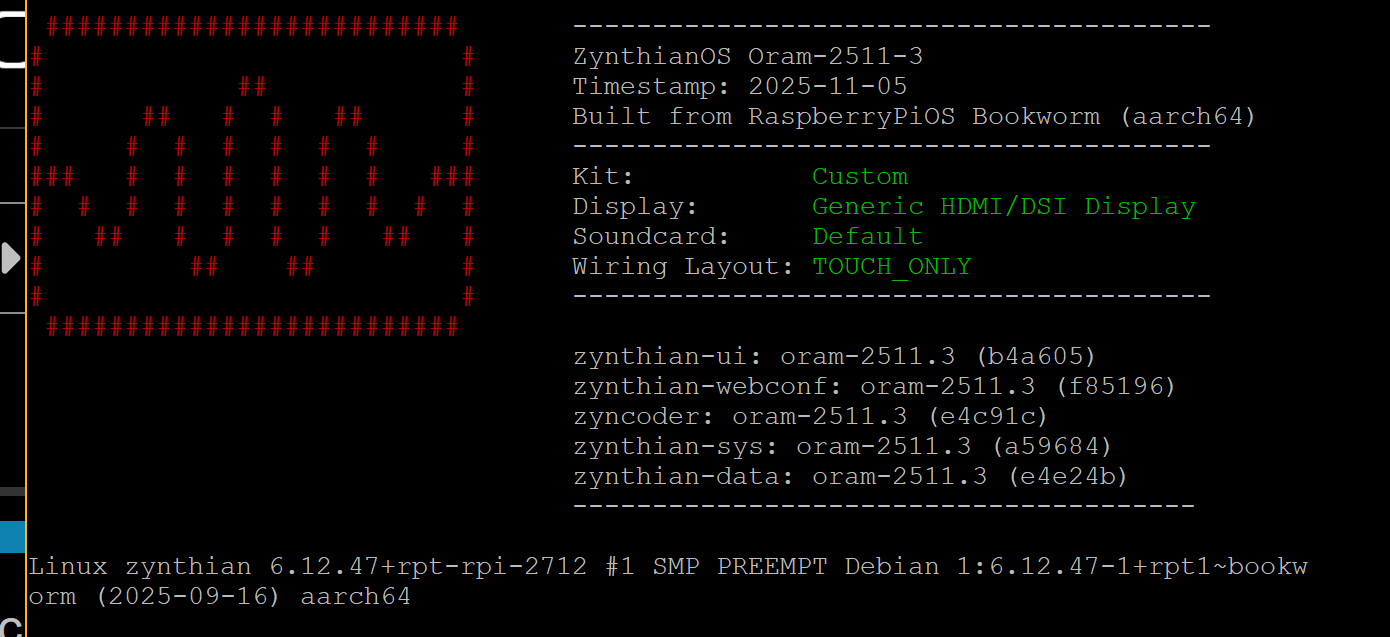

Able to connect via ssh, webconf not apparently loading.
Pi5 output pasted below, OS info in pasted image:

This is rather important - you can’t run zynthian without jack running. You have “Default” as your soundcard so quite possibly you need to configure your soundcard. The topic title saysm “…fresh OS install” but you shouldn’t see that config if you initially start Oram with a valid (known) soundcard attached. You haven’t given any info about the hardware. More info required for us to help.
Hi @crowboat !
This shouldn’t happen, because webconf is needed to configure the soundcard. There is an issue that prevents webconf to run when jackd can’t start. I solved this issue some weeks ago,
but you would need to change to oram staging brand. I would push a new release ASAP with this solved.
